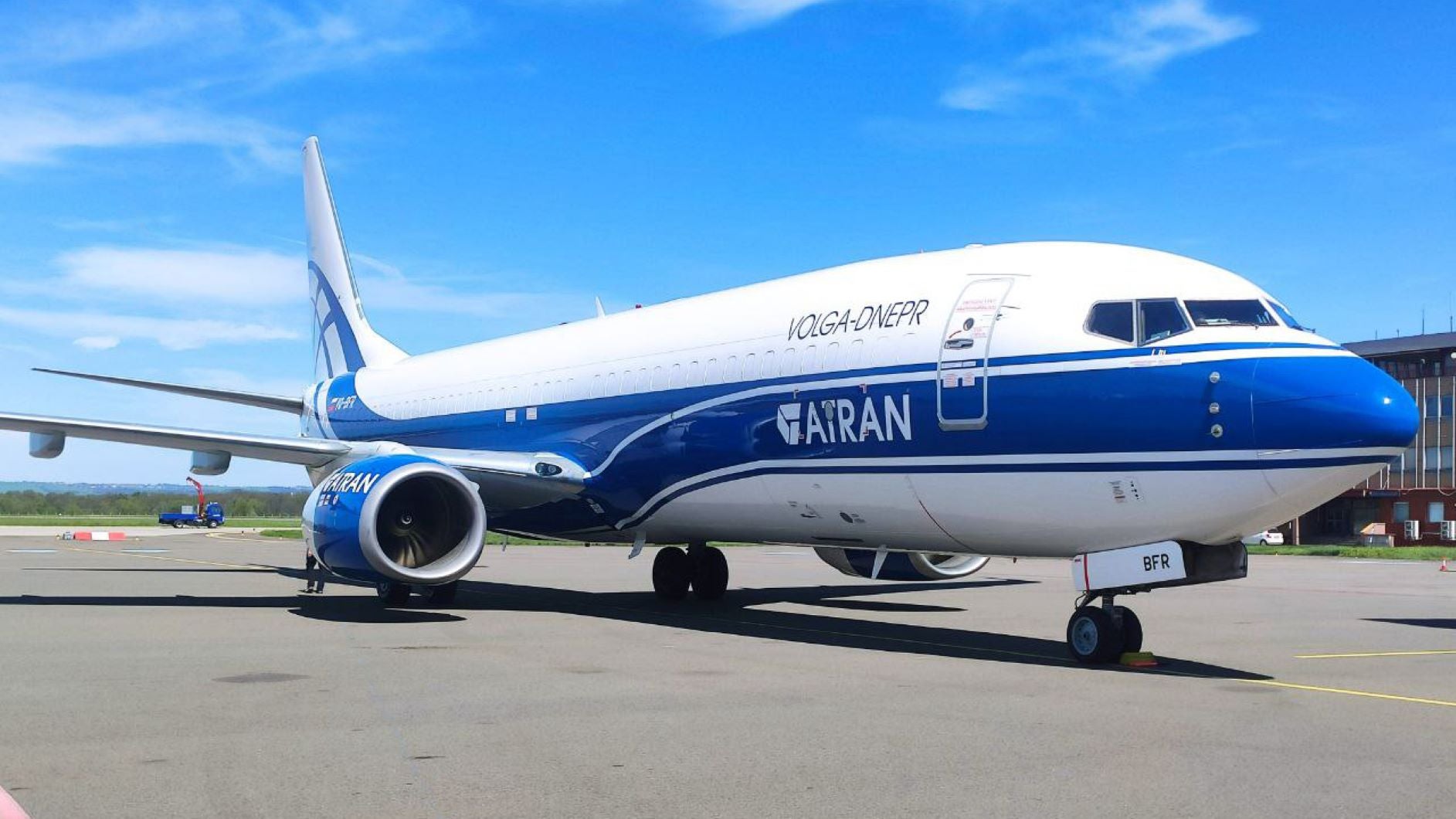

And sales figures appear to bolster the notion that buyers aren’t bothered by any structural differences. Since Boeing launched its 737-800 conversion program in 2016, it has transformed more than 140 aircraft, with 40 more orders booked. ATRAN Airlines, part of Russian-based Volga-Dnepr Group, recently received a 737-800 from GE Capital Aviation Services (GECAS) that was converted by Boeing Shanghai Aviation Services, with a second play slated for delivery later this month.
