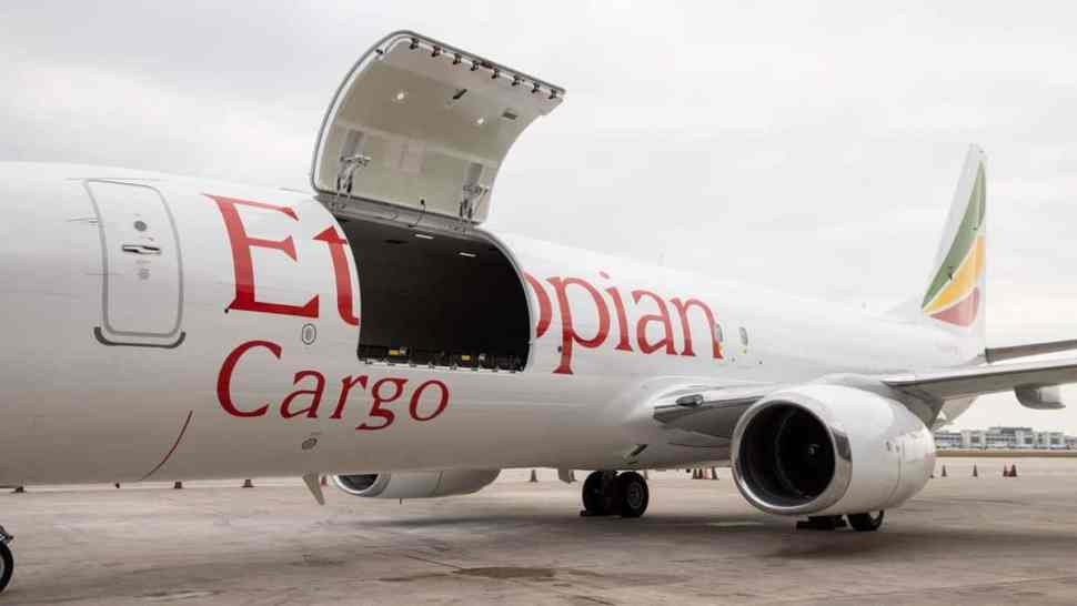

Aeronautical Engineers Inc. converted this Boeing 737-800 for Ethiopian Airlines. (Photo: AEI)

The AEI-converted B737-800SF freighter offers a main deck payload of up to 52,700 pounds and incorporates 11 full-height 88-by-125-inch container positions, plus an additional position for a smaller container. The conversion also incorporates new floor beams, a large main cargo door, a rigid barrier to protect the cockpit, five extra seats, a galley and a lavatory.
