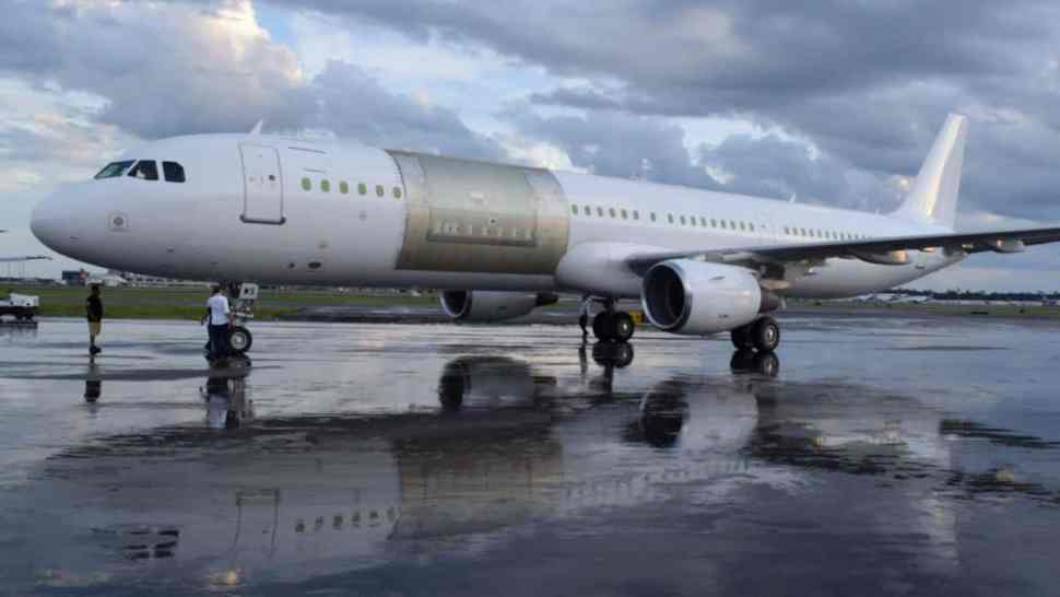

321 Precision Conversions plans to start cutting cargo doors and making other modifications to A321 passenger planes so they can carry palletized cargo. (Photo: 321 Precision Conversions)
A second manufacturer is gearing up to produce Airbus A321 converted freighters in the U.S. this summer, taking on a European engineering firm that is gaining sales momentum eight months after entering the market in the single-aisle freighter segment where the Boeing 737-800 has a three-year head start.

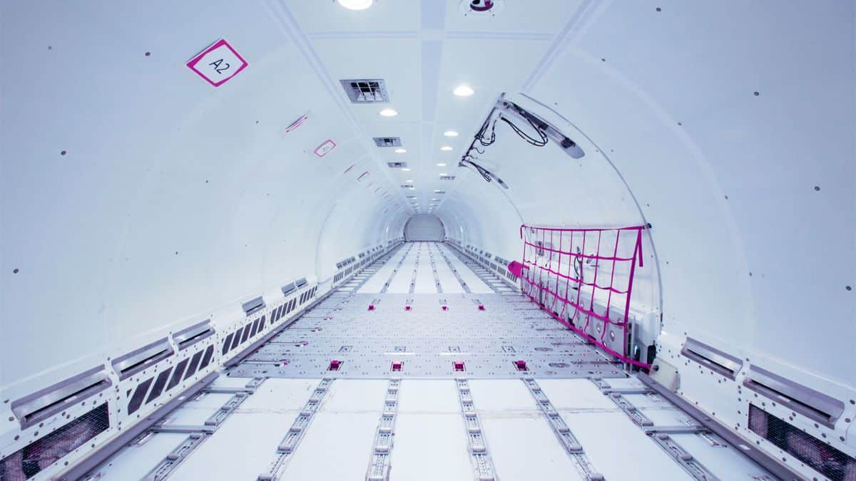

The A321 converted freighter is the first in the narrow-body class to offer containerized loading on both the main and lower decks. It has a payload of about 61,800 pounds and a range of more than 2,300 nautical miles. The 737-800 can only fit loose cargo in the belly hold.
