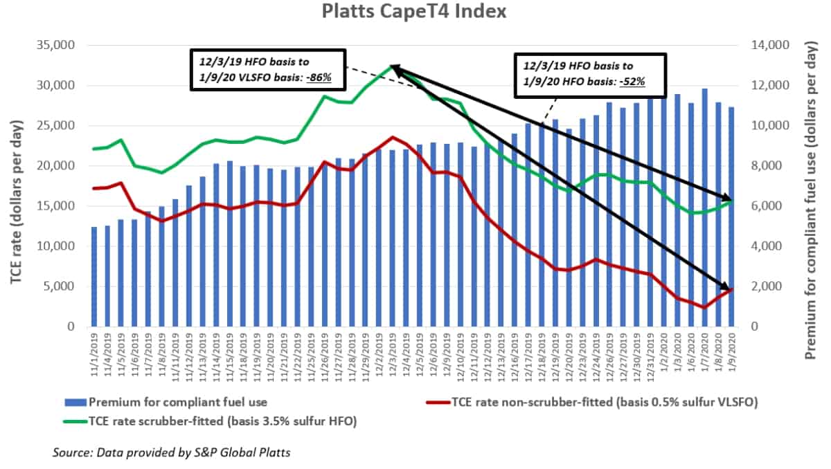

On Oct. 1, Platts debuted its CapeT4 Index, a weighted average of assessments of four Capesize round-trip voyages. On Nov. 1, Platts debuted dual CapeT4 indices, one for ships burning more expensive IMO 2020-compliant 0.5% sulfur fuel known as very low sulfur fuel oil (VLSFO) and one for ships equipped with exhaust-gas scrubbers that are still allowed to burn the cheaper traditional 3.5% sulfur heavy fuel oil (HFO).
Platts derives its index values by starting with the spot rate, charged in dollars per tons of cargo, then translating that into a time-charter-equivalent (TCE) rate measured in dollars per day, which is net of expenses such as fuel. As the cost of fuel increases, spot TCE decreases.
In response to a request from FreightWaves, Platts provided all of the data for its dual CapeT4 indices and the main component indices for the IMO 2020 transition period.
TCE rates for Capesizes consuming HFO (i.e., those with scrubbers after Jan. 1) have fallen from a recent peak of $32,368 per day on Dec. 3, 2019, to $15,558 per day on Jan. 9, a decline of 52%.
Over the same period, the spread between HFO and VLSFO has widened, with Platts’ assessment of the implied premium a Capesize owner must pay for compliant fuel rising from $8,810 per day on Dec. 3, 2019, to $10,928 on Jan. 9, an increase of 24%.
Ships without scrubbers were burning HFO before Jan. 1 and VLSFO after. As a result of the fuel transition and the widening fuel spread, their implied TCE rate, according to the Platts CapeT4 index, fell from $32,368 per day burning HFO on Dec. 3, 2019, to $4,630 per day burning VLSFO on Jan. 9, a decline of 86% over the IMO 2020 transition period.

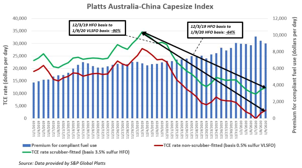

Australia-China Capesize pricing
According to the Platts index, Capesizes consuming cheaper HFO and sailing from Port Hedland, Australia, to Qingdao, China, have seen TCE rates seasonally fall from a recent peak of $34,592 per day on Dec. 3, 2019, to $12,333 per day on Jan. 9, a decline of 64%.
Over the same period, the implied premium a Capesize owner must pay for compliant fuel on this trade lane rose from $6,618 per day on Dec. 3, 2019, to $9,014 per day on Jan. 9, an increase of 36%.
In the Australia-China market, ships without scrubbers saw rates plunge from $34,592 per day burning HFO on Dec. 3, 2019, to $3,319 per day burning VLSFO on Jan. 9, a decline of 90% over the IMO 2020 transition period.
dry bulk rate chart
In the Australia-China trade lane, the VLSFO-HFO fuel spread has increased faster than in the global CapeT4 index, and the rates for scrubber ships (which have been able to continue to burn HFO) have fallen more steeply than in the CapeT4.
In fact, the Pacific Capesize market has been so hard hit by the combination of low demand and high fuel costs that the TCE rate for VLSFO-burning ships briefly turned negative on Jan. 7 (-$98/day) before rebounding. In other words, the cost of fuel for a voyage fleetingly exceeded what a ship without a scrubber would earn.

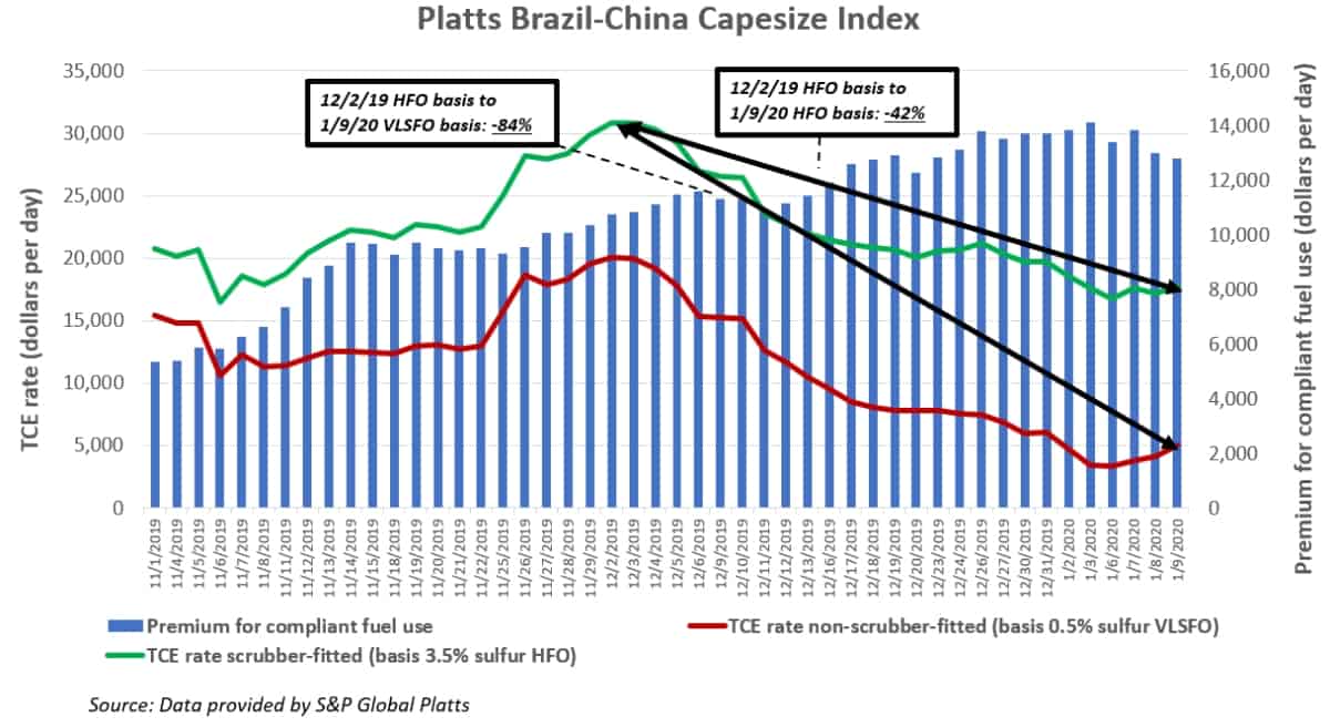

Brazil-China Capesize pricing
Capesizes consuming HFO and sailing from Tubarao, Brazil, to Qingdao, China, have seen TCE rates seasonally fall from a recent peak of $30,813 per day on Dec. 2, 2019, to $17,821 per day on Jan. 9, a decline of 42%.
Over the same period, the implied premium a Capesize owner must pay for compliant fuel on this trade lane rose from $10,740 per day on Dec. 2, 2019, to $12,816 per day on Jan. 9, an increase of 19%.
In the Brazil-China market, ships without scrubbers saw rates fall from $30,813 per day burning HFO on Dec. 2, 2019, to $5,005 per day burning VLSFO on Jan. 9, a decline of 84% over the IMO 2020 transition period.
dry bulk rate chart
The takeaway from the Platts data is that rates in the Brazil-China market appear to have suffered less of a seasonal decline than those in the Australia-China trade over the past month. Also, the premium of VLSFO over HSO has been widening at a slower pace in the Atlantic than in the Pacific Basin.
The Platts indices imply that today’s biggest dry bulk headwind is pressure in the Pacific, both in terms of rising fuel spreads and steeper seasonal declines in spot rates.
