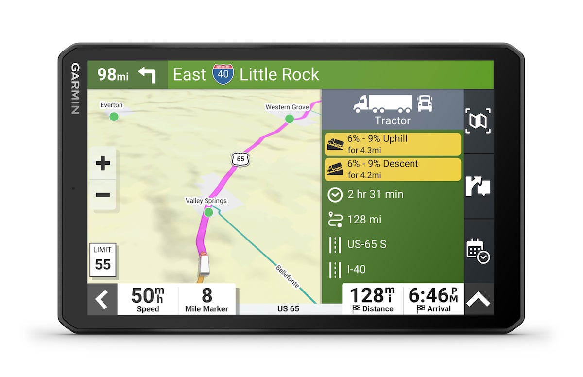

It has a flat, crisp 8-inch full screen that you can turn into a landscape or portrait, and the color and detail is highly improved.
The standard truck gross vehicle weight and trailer length has manual as well as fixed options. Making sure your route provides details of no u-turns, ferries, highways or dirt roads is a breeze. And setting the fastest or shortest mileage route is also easy.

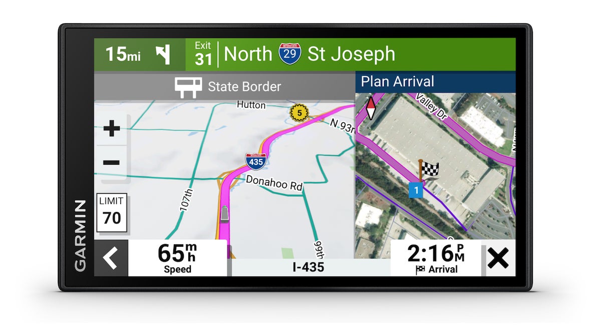

Once I was on my way, the Garmin Dezl OTR810 provided great viewing and operated with detail.
There are a few changes in how to find truck stops, parking and rest areas, but I found they really are more detailed than previous models. On this model, you can enter your truck stop reward cards for fueling and shower request updates. Without downloading, I wasn’t sure if I could mobile fuel, reserve parking or receive my reward points, but the feature to attach your rewards seemed very simple once again with Wi-Fi.
What I love is that someone has finally made a trucking GPS with a bird’s-eye satellite view of a dock and most entrances. I have asked for years why in the world we can’t get a totally satellite view across the board like Google maps. But with this Garmin, there is a choice of a satellite view of your shippers’ and receivers’ facilities. This one also directed me into the truck entrances rather than an address of an entrance — which is usually the main entrance.
The distance and arrival times are still accurate, but I found the weigh station distance no longer was showing. My Dezl 785 shows when you are within 5 miles of a weigh station and then counts down until arrival. I do miss that feature in the new 810, especially when in high-traffic areas and juggling with other trucks getting into the right lane for the scales.
Another feature of Dezl OTR810 allows you to add your prepass so that your weigh station bypass will show on your screen.
Riding down the highway with so many details of what’s ahead and how to plan my day makes the Garmin Dezl 810 a great tool. With so many highways and roads in America, navigation isn’t just about what road to take to get to my destination, It’s about what’s along the way to help me make my travels easier and safer.
With the Dezl 810 features, I find there are more options that help make it an all-in-one device no matter where you go or what you drive.
