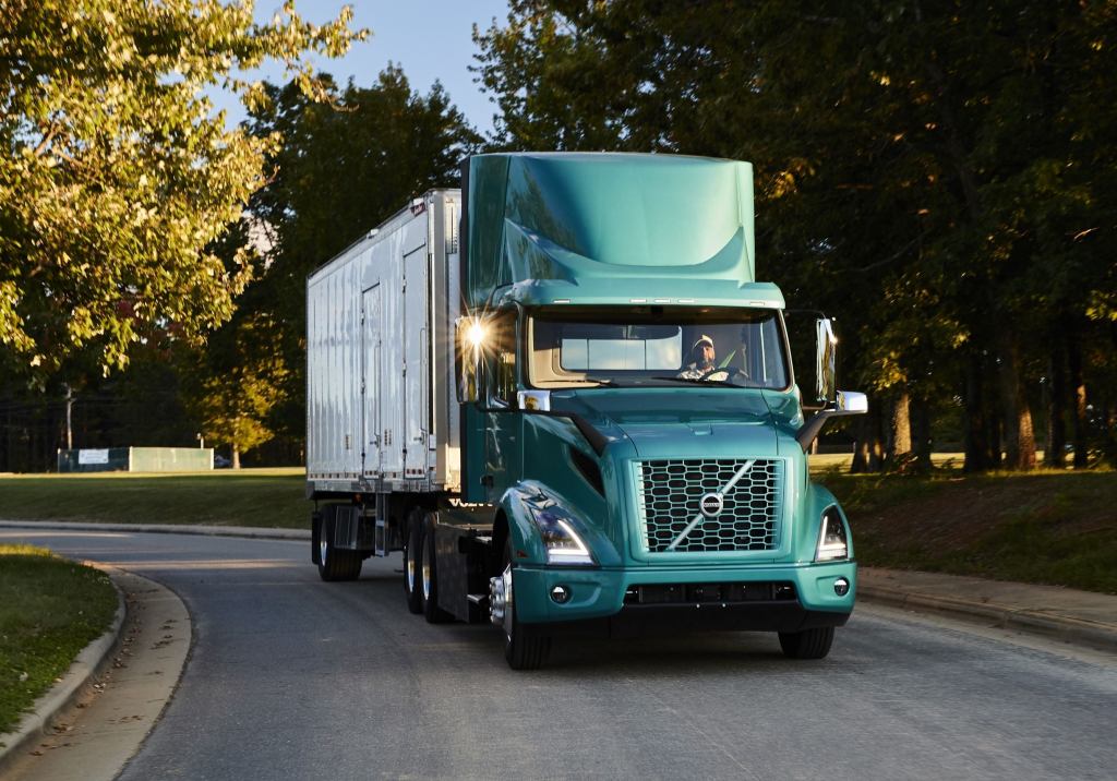

DUBLIN, Va. — The interior of the Class 8 Volvo VNR Electric truck won’t wow you with sleekness. It is utilitarian, practically unchanged from its 2016 introduction. But substituting batteries for an internal combustion engine provides a ride as quiet as any competitor and a single-charge driving range exceeding most.
My strongest takeaway from driving two laps around the private track at Volvo’s manufacturing complex was how energy from slowing down on curves returns to the battery. It is a feeling similar to engine braking on a downhill grade.
But regenerative braking does more than just slow the truck. It captures energy and returns it to the battery as electric motors turn in the opposite direction and become generators. During a typical duty cycle, 5% to 15% of energy expended, such as in stop-and-go traffic, adds range, according to Brett Pope, Volvo Trucks North America director of central sales electric.
Add that extra energy to a six-pack of batteries, and achieving Volvo’s claim of 275 miles of range is doable. Never mind pressing the brake pedal. You won’t do it very often with three choices of regen located on the steering wheel stalk.
Regen is how single-pedal driving is becoming a thing in electric cars and trucks.
