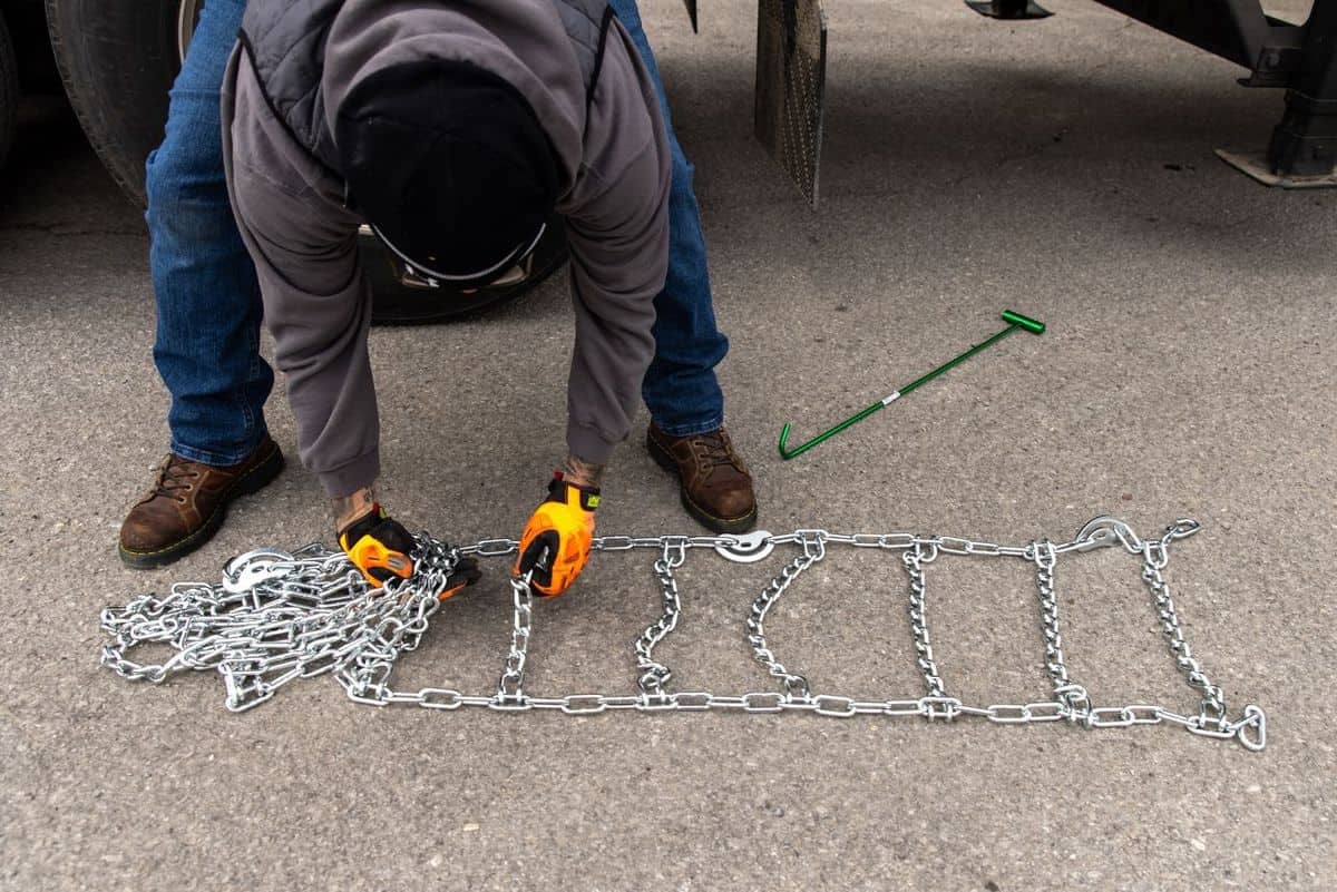

Getting started
Lay the chain flat on the ground next to the tire. With the chain spread out, check for any kinks or twists in the outer and inner chains as well as the cross chains before moving forward.
Next, drape the chain over the top of the tire. Runnels noted that the left-most cross chain should rest against the ground — this may require some adjusting.

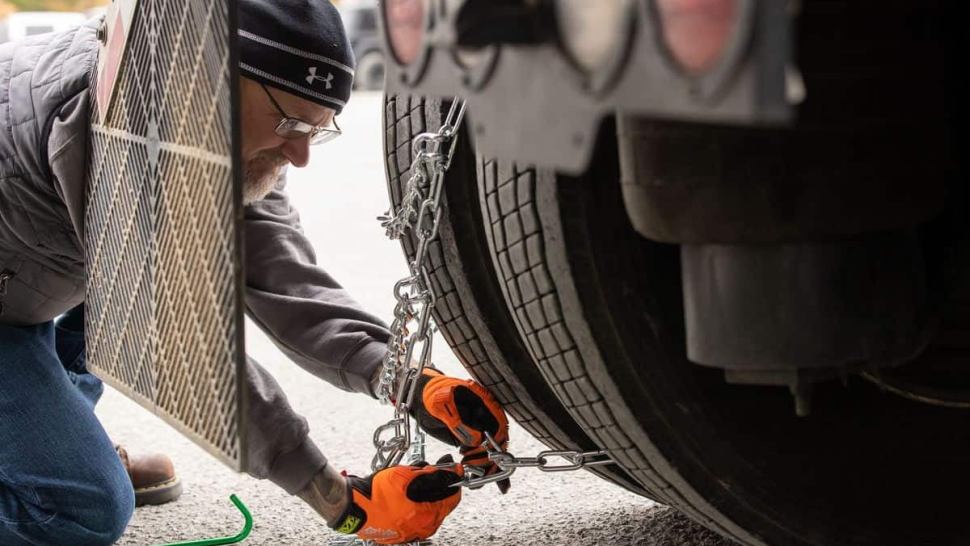

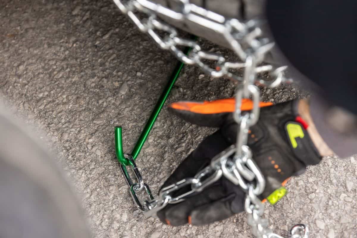

Your next step is to connect the ends, starting first with the inner chain — this is where your fifth-wheel release hook comes in handy.

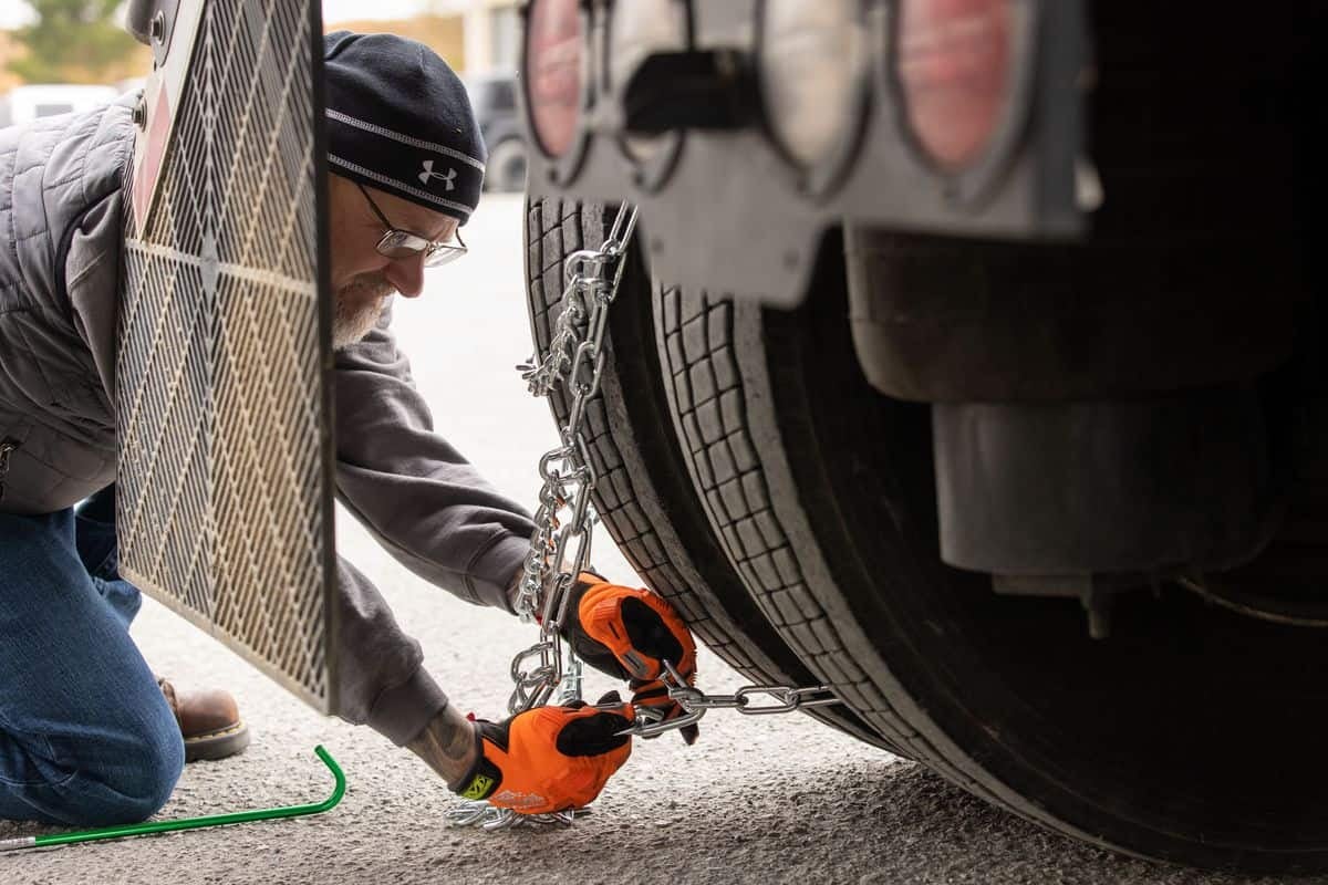

From the right side, slide the hook behind the front tire, hook side up, to meet the chain on the left. Hook the left-most chain to the release hook and promptly slide it back to the right, meeting the other chain. Remember to give the chain some slack. This may require you to briefly place most of the chains behind the tire to make the connection.
With the left-most chain still on the hook, clip the right side’s inner fastener to the second left-most chain — not the first. Now remove the release hook.
Bring the chain back around the tire and make sure that each cross chain is tight and straight.

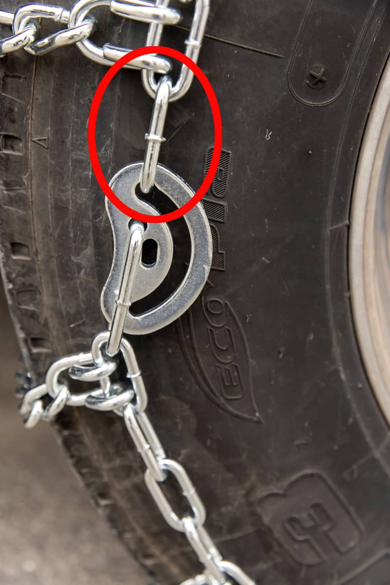

Things get tighter moving forward. The next step is to tighten the cam locks that line the outermost chain. The cam locks are C-shaped and should be facing outward (curved side out).
To begin, use your cam tool to twist each cam lock 180 degrees. Keep in mind that it may become harder to tighten each lock as you work your way around the tire. Upon completion, each cam lock should be oriented curved side in.
Runnels suggests beginning with the lower cams first and working up from there as doing the opposite results in decreasing leverage as you make your way down.
