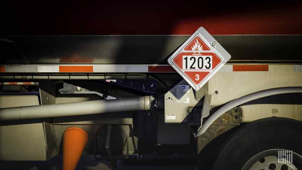

In the event that a leak is detected, whether resulting from an accident or not, Barlar reminds drivers not to rush to judgment. He said to assess the situation by gathering information on the tank and its contents as well as reading the hazardous material placards on the trailer itself.
Barlar said, “Is it leaking? Has the cargo tank become compromised? Is it a low-pressure tank or a high-pressure tank? Is it on its side, rolled over or on its wheels? These are all things that you should take into consideration.”
