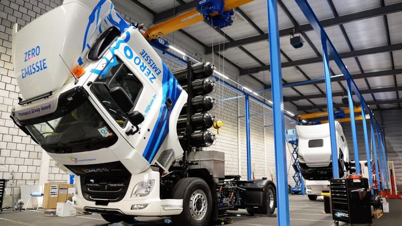

The hydrogen option
Hydrogen also has a role as a transportation fuel, especially for long-haul trucks. BETs typically max out their range on a single charge between 200 and 300 miles. In liquid or gaseous form, hydrogen can fill a truck in about the same time as diesel and match a diesel’s distance between fill ups. It also can be stored for later use.
“Hydrogen is going to become very, very real when we start to answer questions about the grid, and how we’re going to store clean energy on the grid for more than two hours,” Gross said.
Startups Nikola Corp. and Hyzon Motors are both pursuing partners to make hydrogen to power their fuel cell electric trucks. Toyota Motor Corp. plans to build fuel cell systems in Kentucky in 2023, and Daimler Truck and Volvo Group have formed a fuel cell joint venture with trucks sold by both companies in the second half of the decade.
Hyzon Motors hydrogen truck manufacturing. (Photo: Hyzon Motors)
