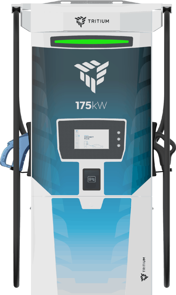

For commercial vehicle fleets to embrace electric trucks, recharging the batteries must be as fast as a diesel fill-up. Australian electric infrastructure hardware producer Tritium is drawing closer, announcing a 175-kilowatt (kW) charger on Tuesday.
The RT175-S can take a battery from 20% to 80% state of charge in 15 minutes with 95% average power efficiency. But the bigger the battery, the longer the charging time. For a Class 4-6 medium-duty truck, charging in less than 30 minutes is in sight. A Class 8 heavy-duty truck would take an hour.
“How fast you can charge is going to depend on the size of the battery based on their duty cycles,” Mike Calise, Tritium’s president of the Americas, told FreightWaves. “I don’t want to say [it’s] accurate for all the trucks out there because they’re all at different battery sizes. But this is ripping fast.”
The all-in cost to install a 175kW Tritium charger is around $100,000, Calise said. With permitting and construction, it could take three months to a year and collaboration with utilities and local government.
Australian-based electric infrastructure hardware supplier Tritium revealed its 175 kilowatt direct current (DC) fast charger on Tuesday, Aug. 18 during the Advanced Clean Transportation (ACT) Virtual Online Event Series. (Photo: Tritium)
