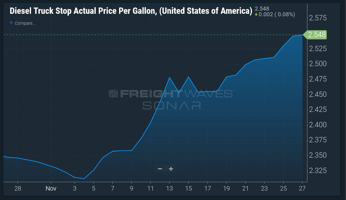

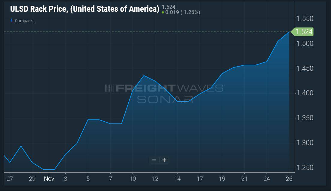

And while the ULSD price on CME is the starting point for determining the ultimate price at the pump, it’s not a price that has direct exposure to truckers. But the prices that do are reflecting the stronger market. The daily retail diesel price reflected in the DTS.USA data series in SONAR was at $2.548 a gallon on Thursday, up from $2.335 on the last day of October, a jump of 20.3 cents a gallon. Wholesale diesel sold at what is known as the “rack” jumped to $1.524 Thursday from $1.247 a gallon at the end of October, up almost 30 cents.
The one area that has been lagging has been the weekly price of average retail diesel reported by the Department of Energy’s Energy Information Administration. That price is the basis for most fuel surcharges.
Given that it is just a weekly price, there will always be a lag on the way down or on the way up. In the price posted Nov. 2, which would have taken in levels at the pump just as October ended, the DOE/EIA price was $2.372 a gallon. In the most recent number, published Monday, it was up just 9 cents over the course of the month, suggesting in comparison to the DTS.USA data series that the DOE number is lagging significantly behind the increases consumers would be paying at retail.
