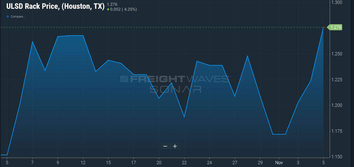

The irony is that even as refiners are talking shutdowns, there have been signs that the weak diesel market may have hit a bottom. Price reporting agencies like S&P Global Platts and Petroleum Argus both reported significant increases in the benchmark spread between diesel in the U.S. Gulf Coast and the ULSD price on CME, a key indicator of physical strength. Combine that with gains on the ULSD CME price and it has sent the wholesale rack price of ULSD in Houston up about 10 cents/gallon over the last few days.
