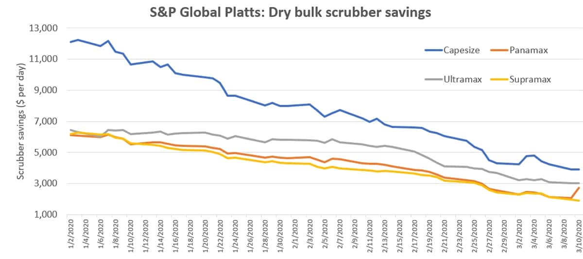

S&P Global Platts began tracking the spread between scrubber-equipped and non-scrubber Capesizes (reference size: 181,000 DWT) in late 2019, via its dual CapeT4 indices. In addition, it has provided FreightWaves with scrubber-savings estimates for three smaller bulker classes: Panamaxes (reference size: 81,000 DWT), Ultramaxes (63,000 DWT) and Supramaxes (57,000 DWT).
While Platts estimates a higher current Capesize scrubber savings than Clarksons, the trend in the Platts data looks the same. From January highs through this Tuesday, Capesize scrubber savings estimated by Platts are down 68%, for Panamaxes down 65%, Ultramaxes 53% and Supramaxes 70%.
Chart data: S&P Global Platts
