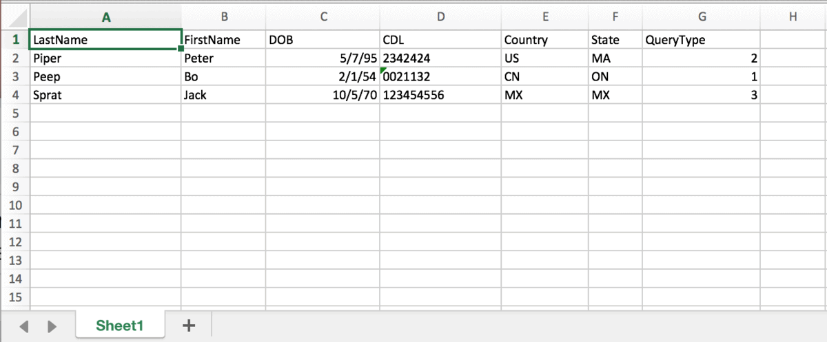

Managers can avoid pestering drivers for their signatures altogether by simply using limited queries for their annuals. Using this format, motor carriers can batch the signatures of their fleet and submit them all at the same time. Seidl noted that the process can be done entirely on an Excel spreadsheet.

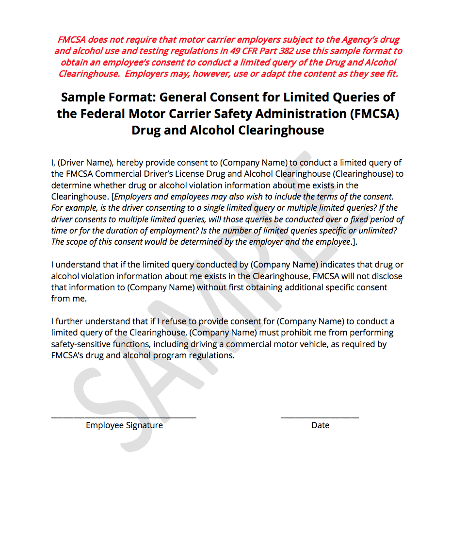

Better yet, Seidl recommends motor carriers have all new drivers sign a limited query consent form during orientation. These forms are written with flexibility in mind, allowing employers to set the duration of consent. In turn, a single signature is all that’s needed to conduct limited annual queries for the entire length of a driver’s tenure with the company.
“Have drivers sign that consent form when you’re hiring them,” Seidl said. “Even though it isn’t necessarily going to be used as you’re conducting the [preemployment] full query, … when your annuals come along, the form is already filled out and signed.”

Sample downloadable general consent form for limited queries.
Image: Drug & Alcohol Clearinghouse
A sample limited consent form can be attained through the FAQ page. First type “consent form” into the search bar. Next, click on the question labeled, “Does the Federal Motor Carrier Safety Administration (FMCSA) provide a sample of a limited consent request?” The following information will provide you a link to the form.
FMCSA also provides a series of bulk upload documents and Excel spreadsheets. To access these files, type “batch” into the FAQ search bar. Next, click on the question titled, “Can I initiate queries for a large number of drivers without having to enter them into the system one at a time?” The provided hyperlink will supply you with the downloadable documents.
“If a company does their annuals, they just need the driver to sign that limited consent form and then upload a limited query with that Excel batch sheet,” Seidl said.
Sample downloadable Excel spreadsheet for bulk upload of driver queries. Source: Drug & Alcohol Clearinghouse
