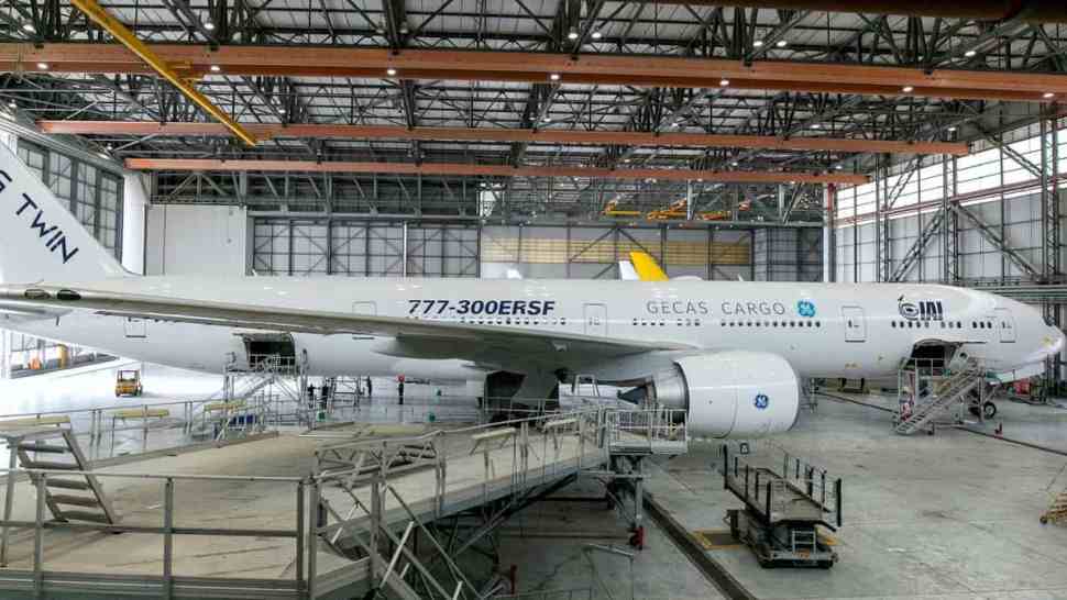

Israel Aerospace Industries will do the metal cutting to turn this Boeing 777 into an all-cargo aircraft. (Photo: GE Capital Aviation Services)
Israel Aerospace Industries has reached a milestone in development of the Boeing 777 passenger-to-freighter conversion program, moving beyond the planning phase to physically modifying the prototype aircraft.
IAI and partner GE Capital Aviation Services, a major leasing company, announced Tuesday that the first extended range 777-300 will officially be inducted into IAI’s Tel Aviv repair facility toward the end of June.

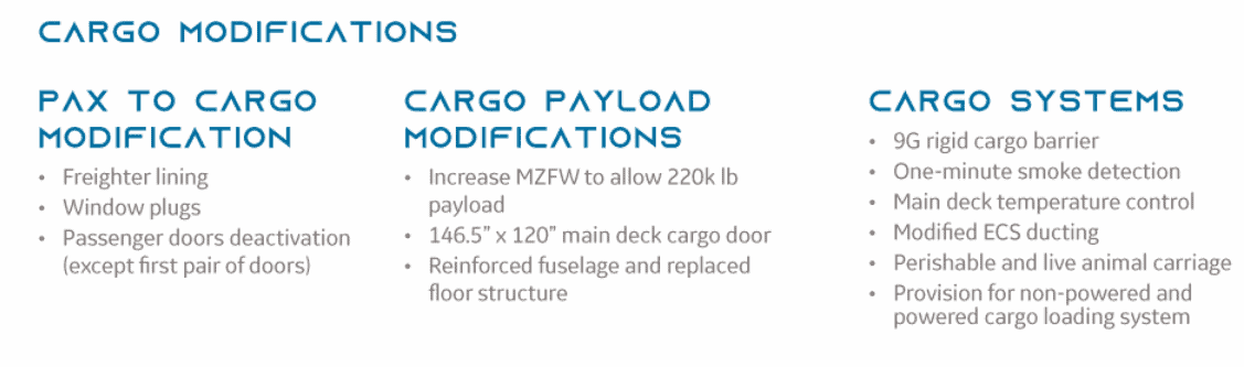

New passenger-to-freighter conversion programs require years of planning, design and engineering work. The actual conversion will involve the addition of a main deck cargo door, window plugs, a modified crew compartment, a reinforced fuselage, a heavy-duty floor that can support 220,000 pounds, a rigid cockpit barrier and a powered cargo-loading system.
