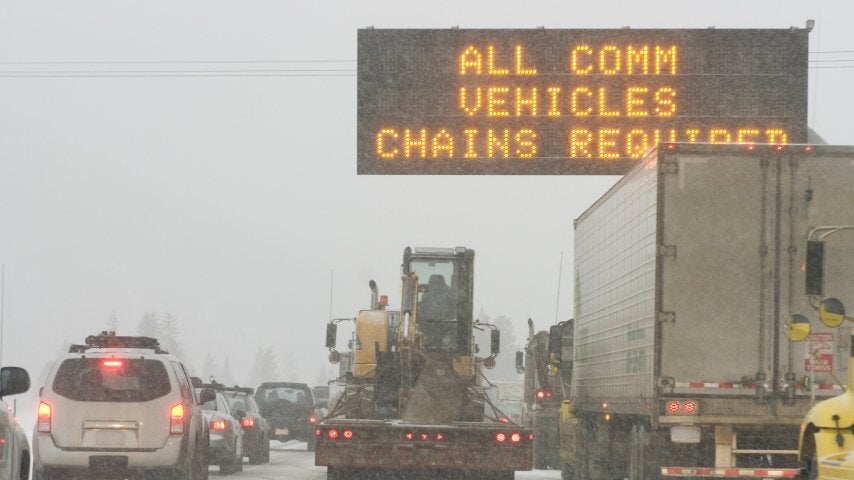

Colorado
Colorado’s commercial vehicle chain law applies to every state, federal and interstate highway within Colorado’s borders. Colorado Department of Transportation static and electronic variable message road signs will notify drivers when they need to put chains on their tires in the event of hazardous winter weather. Truckers must chain up on the four drive tires to be compliant, but chains are not required on trailers.
The enforcement period for the chain law runs from Sept. 1 to May 31. During this time, commercial drivers are only required to carry chains on Interstate 70 between the Dotsero (Milepost 133) and Morrison exits (Milepost 259). This is because weather can change very quickly along this stretch of highway, and drivers may have to chain up at a moment’s notice. The fine for not carrying chains is $50 plus a $17 surcharge.
The following fines apply statewide:
• $500 plus a $79 surcharge for not installing chains when required.
• $1,000 plus a $157 surcharge for blocking a road as a result of not installing chains.

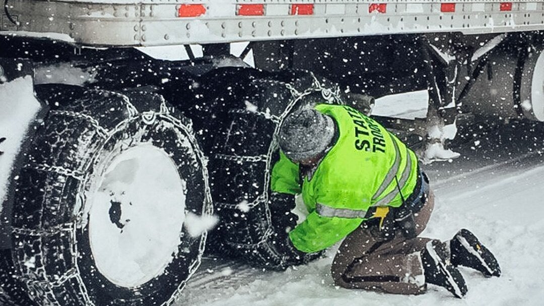

(Photo: Colorado State Patrol)
Joel Waidner, a trucker for Schuster, told FreightWaves he’s driven through several winter storms in Colorado with previous companies. Depending on how hard it was snowing when it came time to chain up, Waidner said it took him about 45 minutes to an hour.
“I keep a block in my truck and I drive up on it, then I slide them [the chains] on, and I have a tool that clamps them down,” Waidner explained.
He admitted he would rather not spend the time chaining up because time is money. But when it comes down to risking an accident and breaking the law versus waiting out the storm, he waits out the storm. Waidner said he’s seen serious wrecks resulting from truck drivers not putting chains on their tires.
“Your life ain’t worth the freight. Your life ain’t worth taking the chance,” Waidner added.

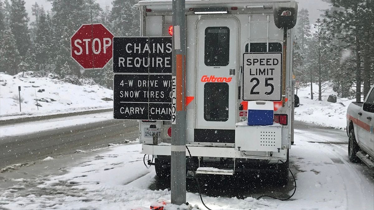

California
California does not have any specific dates during which commercial drivers are required to carry chains. When roads are posted with signs saying that chains are required, all heavy-duty vehicles with a GVW of more than 6,500 pounds must be equipped with chains mounted on the tires in order to proceed.
Drivers can use conventional tire chains and cable chains, as well as less conventional devices like a Spikes-Spider. Which tires and how many of them must be chained depends on the chain requirement level posted.
(Photo: Caltrans)
Drivers may be cited by the California Highway Patrol (CHP) and fined for violating the chain law, but the CHP hasn’t responded to FreightWaves’ questions regarding how much the fines are.
Chains are most often required in the higher mountain passes of Northern California, such as on Interstate 5 north of Redding; Interstate 80 over Donner Pass between Sacramento and Reno; as well as U.S. Highway 50 over Echo Summit between Lake Tahoe and Sacramento.
