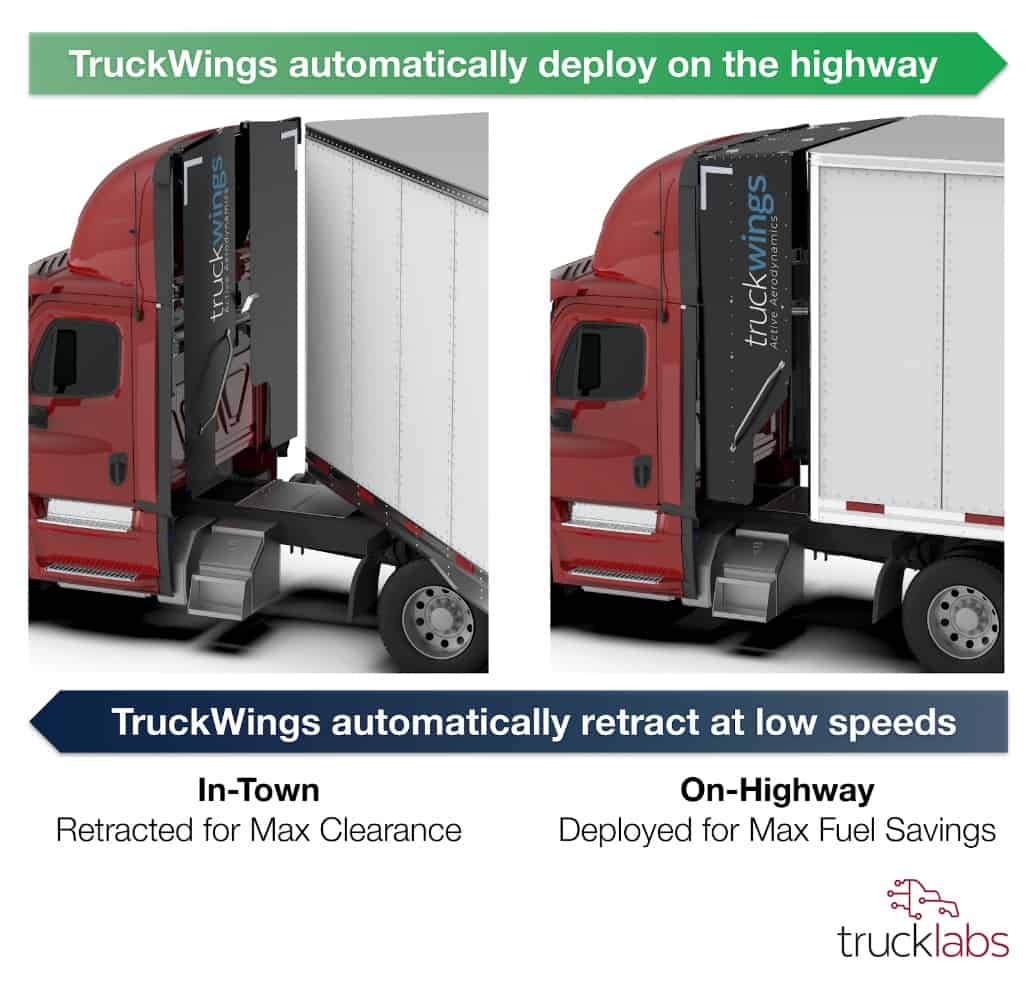

At 49 mph or slower, TruckWings — a product from TruckLabs that reduces aerodynamic drag — remains safely nestled behind a cab, silently waiting to go into action. Then the speedometer reaches 50 mph.
Time to come out of hiding.
Thanks to the smart sensors that minimize driver involvement, the glass-reinforced polypropylene panels automatically deploy. Two on the side, one on the top, the panels expand to close the gap between the tractor and trailer as the truck rolls down the highway.

More than 200 million highway miles in the U.S. and Canada have been logged since TruckWings became available in 2015. The 240-pound average TruckWing system can be installed in less than two hours when shipped fully assembled.

A 2020 CFD Assessment of the TruckWings Drag Reduction Device conducted by TotalSIM U.S. concluded that when TruckWings shrinks the tractor-trailer gap from 52 inches to 18 inches, it demonstrates a 7.5% reduction in drag. The study was based on a 53-foot Class 8 truck with a driving speed of 65 mph and wind speed of 7 mph.
