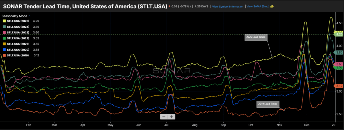

Chart of the Week:  SONAR Tender Lead Time Index – USA SONARSTLT.USA Seasonality View
Shipper tender lead times for requesting truckload capacity increased 7.3% to 3.63 days in 2025, up from 3.38 days in 2024. This represents a 39% increase over the average lead time in 2019 and marks the sixth consecutive year in which shippers have given carriers more time to cover contracted loads. While truckload tender lead times may not be a headline statistic, they are a strong indicator that shippers have improved their ability to anticipate freight movements, while also helping carriers keep capacity more readily available.
The SONAR Tender Lead Time index (STLT) measures the time between a shipper’s request for coverage and the requested pickup date. For example, if a shipper tenders a load on January 5 with a pickup date of January 9, the lead time is four days. Generally, an ideal lead time falls between three and six days, as this allows carriers sufficient time to reposition equipment into the pickup market.
The fact that shippers are giving carriers a full day more to position trucks than they did in 2019 is remarkable. Prior to the pandemic, markets with ample capacity typically experienced lead-time compression. In fact, average lead times shrank by roughly 4% from 2018 to 2019 as capacity loosened.

From 2023 to 2024, lead times increased by just 1.1%, the smallest gain of the past six years. This is notable given that tender rejection rates averaged more than one percentage point higher in 2024, suggesting slightly more challenging capacity conditions. While some may have expected a larger increase in lead times, it is possible that the rise in rejection rates was not significant enough to meaningfully alter shipper behavior.

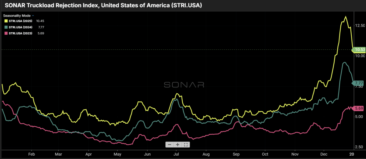

Tender rejection rates measure carriers’ willingness and ability to cover contracted freight. When national rejection rates are below 5%, capacity is generally abundant. Rates above 9% signal a much more challenging environment, where spot market rates tend to rise rapidly.
The average rejection rate in 2025 was just above 6%, compared to just under 5% in 2024. In 2023, the average rejection rate was approximately 3.85%.
Rejection rates increased by a similar magnitude from 2024 to 2025 as they did from 2023 to 2024, yet lead times surged in the most recent year. This may suggest that a threshold for shipper service expectations was breached.
