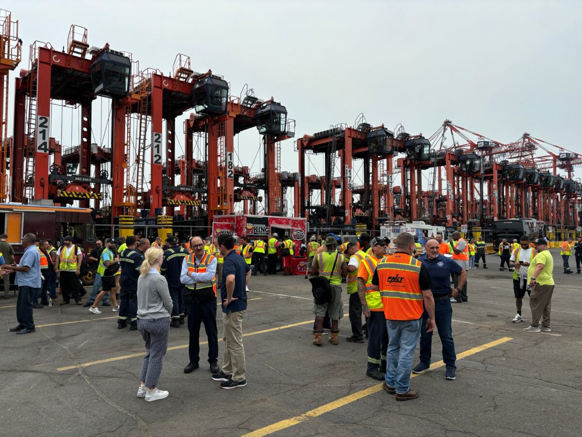

A shift to propane is underway at one New Jersey port. (Photo: FreightWaves)

The event featured several propane-powered food trucks that brought a good chunk of the PNCT workforce over at lunchtime to grab a free meal.
Charlie Ferlisi, the port’s director of engineering and equipment services, who led a bus tour of the port, said the number of propane-powered tractors for the intermodal movement at PNCT is now 20. The entire fleet is 45. Ferris said he expects that number to double by the end of the year.
