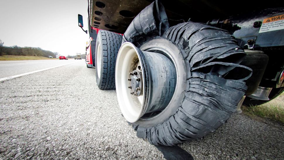

Tire blowouts are a critical safety issue for autonomous trucks to deal with before commercialization. (Photo: Jim Allen/FreightWaves)
Tire blowouts lead to dozens of highway deaths every year. For autonomous trucks, they pose a prickly problem: how to regain control without a human driver at the wheel.
