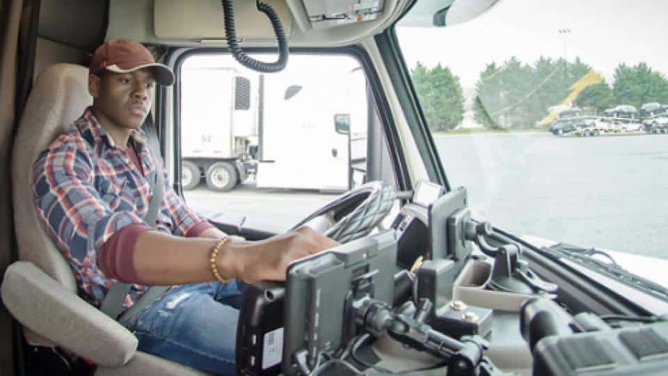

ELDs have changed trucking. (Photo credit: JIm Allen/FreightWaves)
