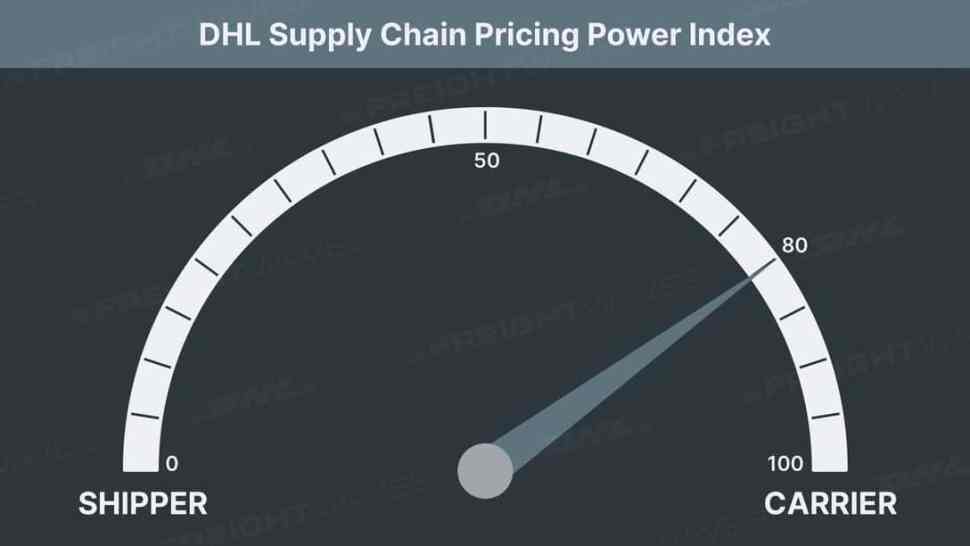

This week’s DHL Supply Chain Pricing Power Index: 80 (Carriers)
Last week’s DHL Supply Chain Pricing Power Index: 85 (Carriers)
Three-month DHL Supply Chain Pricing Power Index Outlook: 80 (Carriers)
The DHL Supply Chain Pricing Power Index uses the analytics and data in FreightWaves SONAR to analyze the market and estimate the negotiating power for rates between shippers and carriers.
It may be time to call the top, but it also may be meaningless. Freight volumes may have peaked, but they will remain elevated double digits over last year for the foreseeable future. Tender rejections may have peaked near Labor Day, but carriers will be rejecting freight so long as spot rates outpace contract. So when we say the market may be peaking, don’t expect any sudden changes. The underlying dynamics of the market remain: Capacity is fundamentally constrained and demand is unwavering with strong imports and retail demand.
