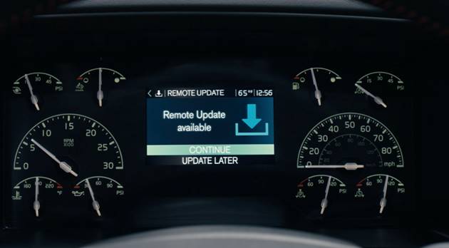

Volvo said its Driver Display Activation will flash an icon on the instrument cluster screen when parameters or software updates are available. At the next planned stop, the driver can activate the update 50% faster than a dispatcher and be back on the road within minutes, according to Ash Makki, VTNA product manager.
