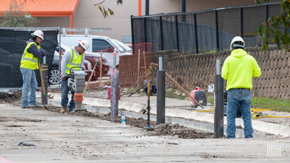

A recent court decision against a construction company serves as notice to all employers that OSHA violations, even when wrongfully and willfully encouraged by a supervisor, can still result in liability to the employer. (Photo: Jim Allen/FreightWaves)
