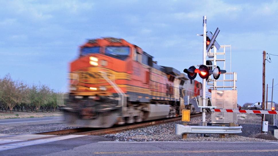

A BNSF train at a grade crossing. Image: Flickr/Patrick Dirden
Congress should consider drafting legislation defining what role each stakeholder has to play in reducing blocked crossings, several witnesses at a recent U.S. House hearing said.
