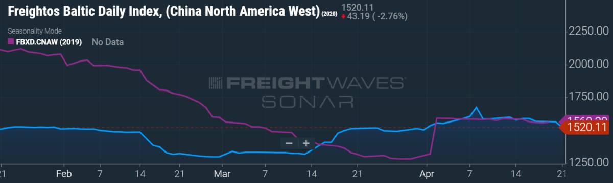

So far, carriers have kept pricing steady, which should allow them to remain solvent — assuming they can keep it up. The price to ship a forty-foot equivalent unit (FEU) container from China to the U.S. West Coast (SONAR: FBXD.CNAW) is very close to what it was a year ago, according to the Freightos Baltic Daily Index.

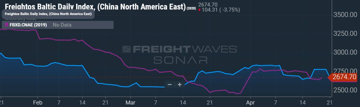

The same is true on the China-to-U.S. East Coast route (SONAR: FBXD.CNAE). Rates are essentially flat year-on-year.
Even if carriers have reduced capacity perfectly in line with lost demand, rates should still be down year-on-year because the cost of fuel is much lower, down 44% year-on-year — and yet, rates are not lower.
Lars Jensen, CEO of Copenhagen-based SeaIntelligence Consulting, highlighted the “remarkable resilience of container freight rates” in an online post, noting that “there is, as yet, not a hint of the lower oil prices undermining the rate levels.” Click for more FreightWaves/American Shipper articles by Greg Miller
