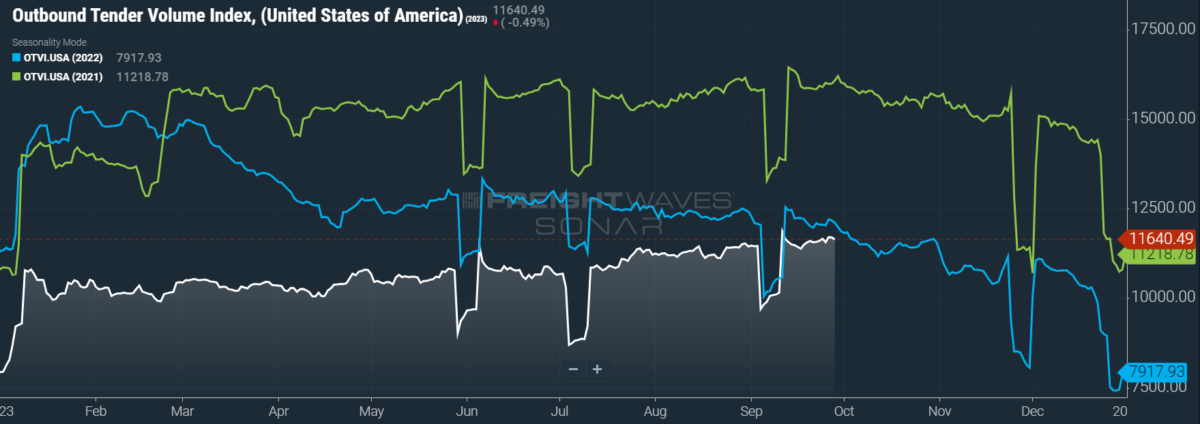

This week, the Outbound Tender Volume Index (OTVI), which measures national freight demand by shippers’ requests for capacity, rose 0.68% week over week (w/w). On a year-over-year (y/y) basis, OTVI is down 2.86%, though such y/y comparisons can be colored by significant shifts in tender rejections. OTVI, which includes both accepted and rejected tenders, can be inflated by an uptick in the Outbound Tender Reject Index (OTRI).

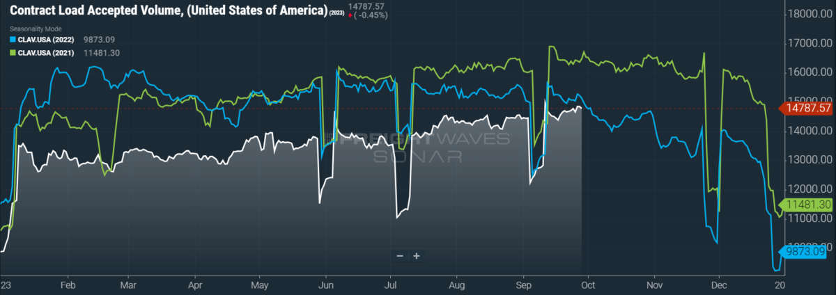

Contract Load Accepted Volume (CLAV) is an index that measures accepted load volumes moving under contracted agreements. In short, it is similar to OTVI but without the rejected tenders. Looking at accepted tender volumes, we see a rise of 0.97% w/w as well as a fall of 2.47% y/y. This narrowing y/y difference implies that actual freight flow is recovering from this cycle’s bottom.

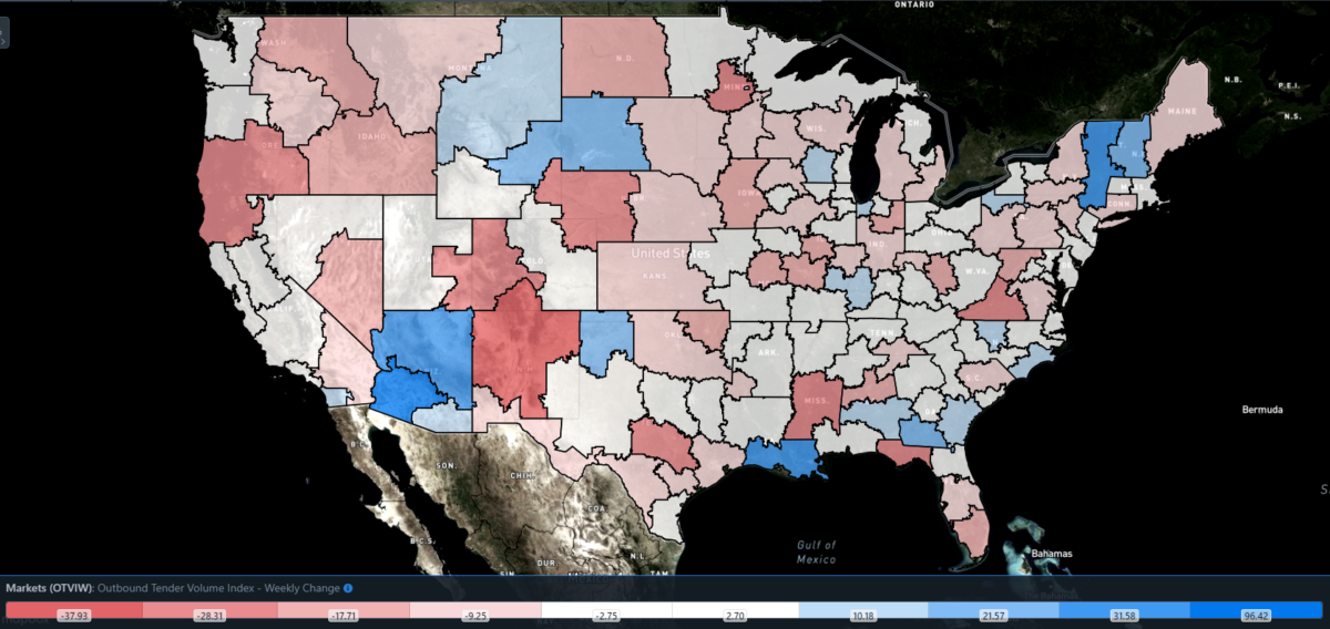

Major markets offer a mixed bag of weekly performances:
SONAR: Outbound Tender Volume Index – Weekly Change (OTVIW).
To learn more about FreightWaves SONAR,
click here.
Of the 135 total markets, 63 reported weekly increases in tender volumes, though the lion’s share of heavyweight markets saw slight declines in freight activity.
The most noteworthy market this week was, by far, that of Phoenix. Phoenix has rapidly garnered a reputation as a burgeoning hub for logistics as it has become one of the fastest-growing markets for industrial real estate over the past few years. This week, outbound tenders from Phoenix rose 96.4% w/w, though there is a caveat for long-haul truckers: The vast majority of these loads are local, moving fewer than 100 miles, and Phoenix’s average lead time for outbound shipments just shrank from 2.5 to 1.75 days. Taken together, this data suggests a kind of short-term repositioning project that is not indicative of future strength at this level. Even so, Phoenix is a developing market that often presents these kinds of opportunities.

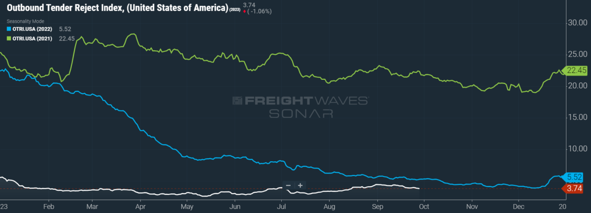

Disappointingly, rejection rates tumbled along a protracted slide since peaking in early September, though OTRI yet remains in line with March’s highest reading. If OTRI remains strictly buffeted by seasonal trends, it is likely that it will continue to fall further: Even in the busy year of 2021, OTRI did not see any upward movement worth mentioning until the back half of December. That said, OTRI did see a significant recovery in 2019 as early as mid-November. Near-term potential for chaos could accelerate this timeline.
OTRI’s recovery threatened by stagnation:
SONAR: OTRI.USA: 2023 (white), 2022 (blue) and 2021 (green)
To learn more about FreightWaves SONARclick here.
Over the past week, OTRI, which measures relative capacity in the market, fell to 3.74%, a change of 11 basis points from the week prior. OTRI is now 148 bps below year-ago levels, with y/y comparisons becoming more favorable even if OTRI just remains stable.

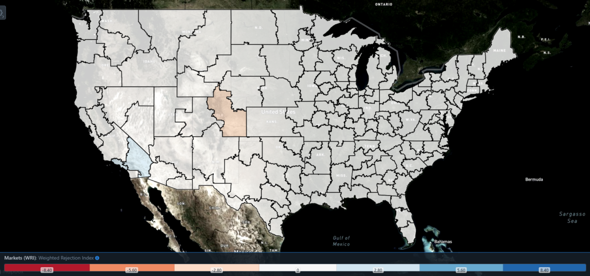

The map above shows the Weighted Rejection Index (WRI), the product of the Outbound Tender Reject Index – Weekly Change and Outbound Tender Market Share, as a way to prioritize rejection rate changes. As capacity is generally finding freight this week, only a few regions posted blue markets, which are usually the ones to focus on.
Of the 135 markets, 67 reported higher rejection rates over the past week, though 49 of those saw increases of only 100 or fewer bps.

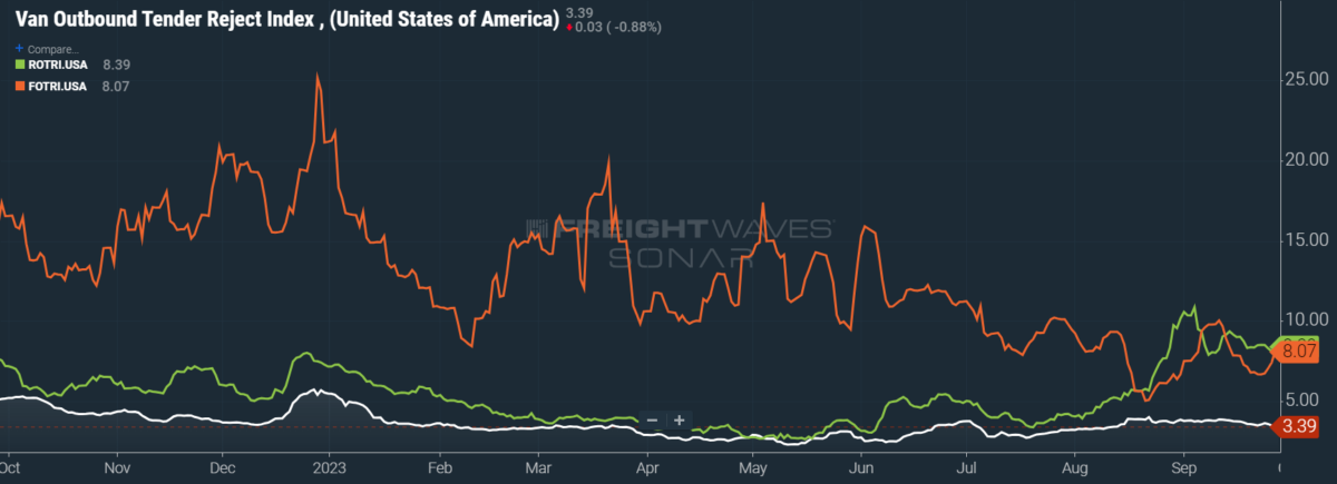

By mode: Flatbed demand is struggling against a number of headwinds, such as an industrial economy brought to heel by high federal interest rates and the slowing construction sector. The Flatbed Outbound Tender Reject Index (FOTRI) did rise 125 bps w/w to 8.07%, but its ceiling appears to be within the single digits for now — a far cry from its reading at 16% at this time last year.
In contrast to current trends in reefer volume, reefer rejection rates have remained fairly stable over the past month. The Reefer Outbound Tender Reject Index (ROTRI), which rose 4 bps w/w to 8.39%, is even outpacing FOTRI for the first time since early 2022. Van rejection rates, meanwhile, have returned to the levels of early August, with the Van Outbound Tender Reject Index (VOTRI) sliding 15 bps w/w to 3.39%.

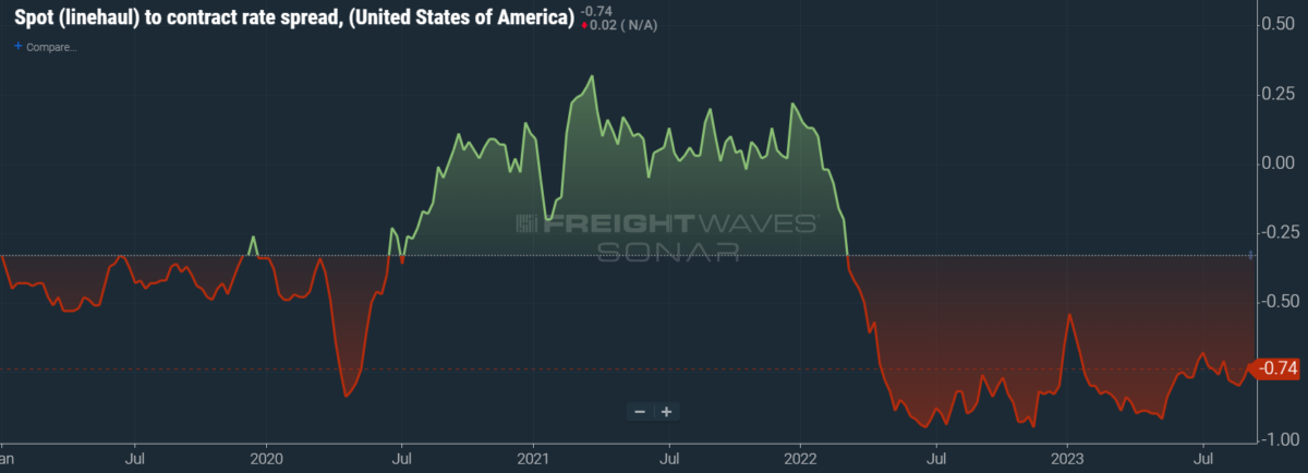

The chart above shows the spread between the NTIL and dry van contract rates, revealing the index has fallen to all-time lows in the data set, which dates to early 2019. Throughout that year, contract rates exceeded spot rates, leading to a record number of bankruptcies in the space. Once COVID-19 spread, spot rates reacted quickly, rising to record highs seemingly weekly, while contract rates slowly crept higher throughout 2021.
Despite this spread narrowing significantly early in the year, tightening by 20 cents per mile in January, it has widened again throughout the year to date. As linehaul spot rates remain 74 cents below contract rates, there is still plenty of room for contract rates to decline — or for spot rates to rise — in the remainder of the year.

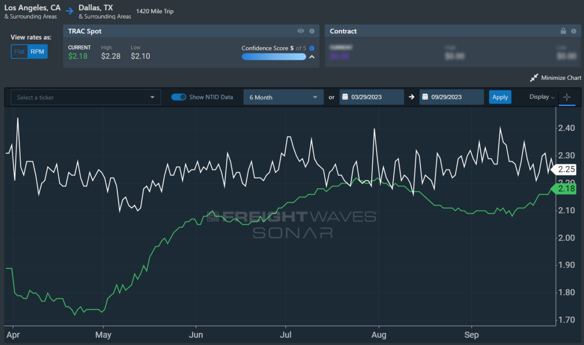

The FreightWaves Trusted Rate Assessment Consortium (TRAC) spot rate from Los Angeles to Dallas, arguably one of the densest freight lanes in the country, is finding its footing once again. Over the past week, the TRAC rate rose 6 cents per mile to $2.18 — still some distance from its year-to-date high of $2.39. The daily NTI (NTID), which has fallen to $2.25, is handily outpacing rates along this lane.

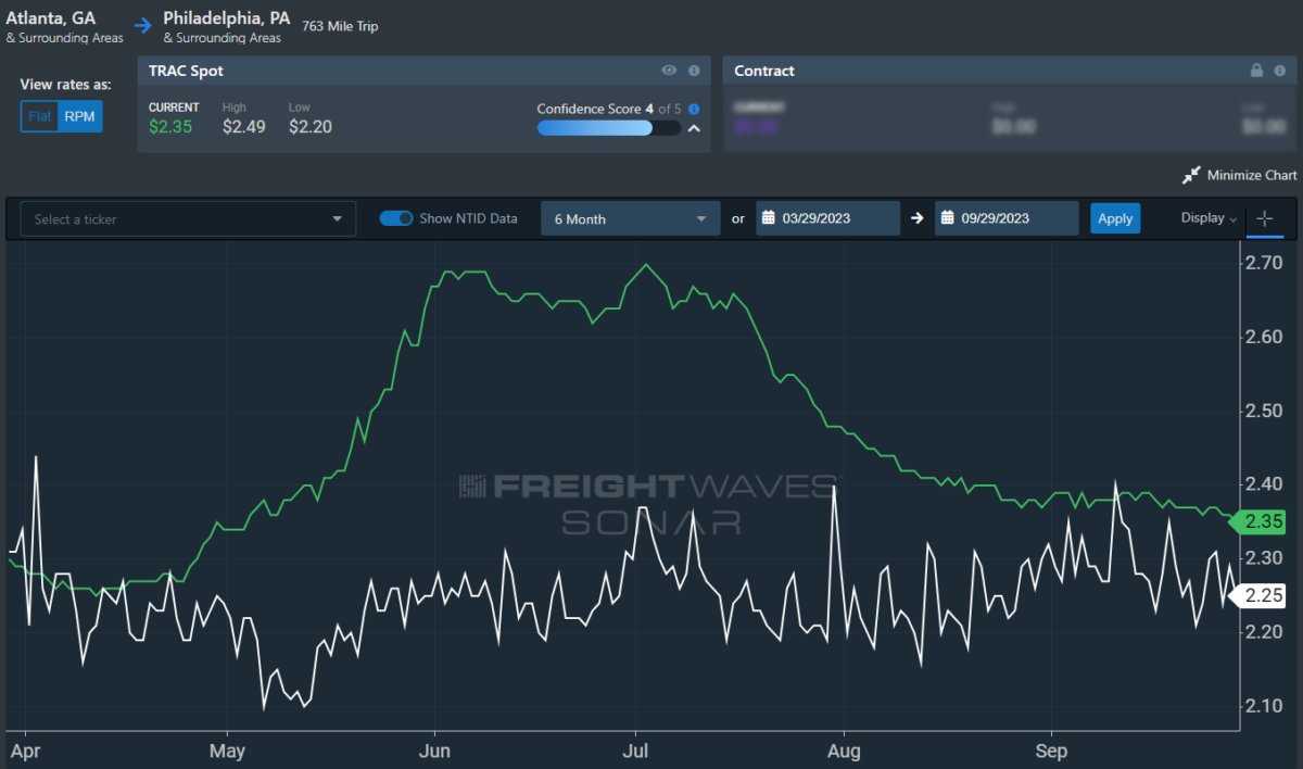

On the East Coast, especially out of Atlanta, rates have come down from July’s early peak but are still outpacing the NTID. The FreightWaves TRAC rate from Atlanta to Philadelphia fell 1 cent per mile to $2.36. After a bull run that started at the end of April, this lane had been plateauing above the national average, which made north-to-south lanes in the East far more attractive than West Coast alternatives.
