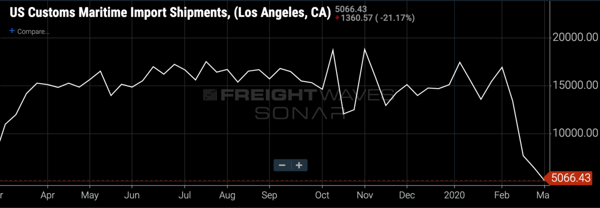

We have a good idea of the volume hitting West Coast ports and what’s underway on the ocean.

Yet at this point, the coronavirus impact has yet to make itself felt across the broader over-the-road trucking industry, even though spot markets are already pricing in Los Angeles weakness by charging more to enter the market and less — as little as $1-$1.15 including fuel — to leave.
The American Association of Port Authorities has said U.S. port volumes could be down 20% in the first quarter; at some point, that has to make an impact on demand for trucking services. But if anything, at this point, consumers are buying at an accelerated pace in anticipation of quarantines or shortages which may or may not come, with the overall effect of boosting demand.

Over the course of the next week, we’ll have a better understanding of how import shipments develop: If volumes stay lower for longer, it’s more likely that relative capacity loosens and spot rates get pulled down even further. We’ve already seen moves by Maersk that suggest China outbound container volumes will be weak for a while; the Danish steamship line raised rates from Northern Europe to China, effectively pricing it like a backhaul market.
