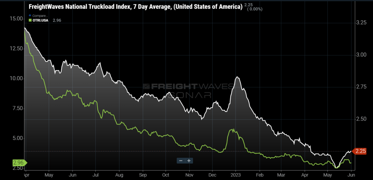

Truckload spot rates increased marginally compared to month-ago levels while tender rejection rates barely moved over the last two weeks of May, providing little hope to transportation providers that capacity has corrected noticeably.
The National Truckload Index (NTI), which measures average spot rates for dry van loads moving more than 250 miles nationwide, did jump significantly when compared to mid-May levels, but was only up 3 cents per mile (1%) from where it started the month.
The national Outbound Tender Rejection Index (OTRI), which measures how often carriers turn down load requests from their contract customers, only barely moved back over 3% for a few days at the end of the month — values under 4% are indicative of extremely soft/loose environments.
To put this into perspective, capacity tends to tighten around Memorial Day, pushing rejection and spot rates higher. Both indexes have shown increases on some level around the holiday since they were created from the years before and during the pandemic. The levels of increase have varied widely.
Some within the industry expected Roadcheck week and Memorial Day to be the inflection point that signaled the bottom of the market was behind us. There is some argument to be made looking at current trends that demand has potentially hit a floor. (The jury is still out on this one.) It is still too early to say that the market will be easier to navigate for transportation providers.

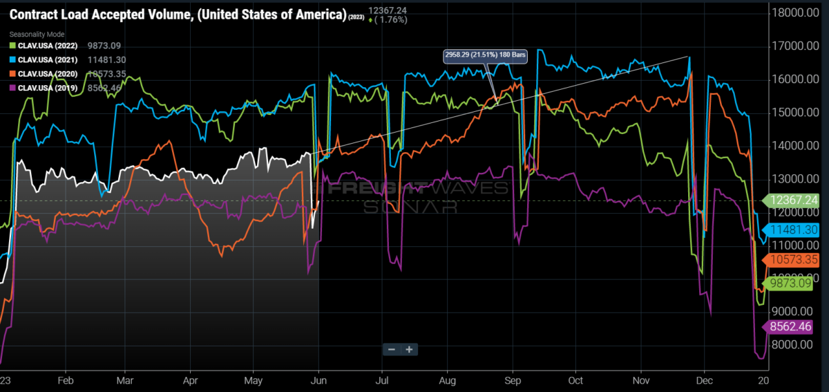

As mentioned in an earlier article, it will take a while for capacity to exit the domestic truckload market. Carriers were handling 22% more freight at the end of 2021 than they did this past week, according to the Contract Load Accepted Volume Index (CLAV).
The CLAV measures loads that carriers accepted and moved for their contracted customers. Considering many carriers also had some percentage of their capacity on the spot market, this number is probably understated in terms of their capabilities.
The CLAV is biased toward larger fleets with electronic tendering capabilities. This sector has largely been growing their fleet sizes by acquiring other operations that are struggling — smaller operators have been feeling the brunt of this downturn the most. This process keeps capacity in the market longer.
