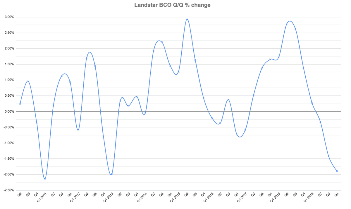

The FreightWaves PASSPORT research team has been experimenting with one data set that appears to show directional moves in absolute capacity – the number of business capacity owners (BCOs), or owner-operators, working for Landstar (NASDAQ: LSTR). Specifically, we believe that the rate of quarter-on-quarter growth in Landstar BCOs indicates carrier sentiment and risk tolerance, and provides a view into absolute capacity.
Briefly put, when trucking rates are strong, carrier sentiment is bullish, and capacity is entering the market, more company drivers strike out on their own to become owner-operators and growth in Landstar’s BCO fleet accelerates. When trucking rates are soft, carrier sentiment is bearish, and capacity exits the market. Owner-operators exit the industry or become company drivers and growth in Landstar’s BCO fleet decelerates and turns negative.
(Chart: Landstar financial statements; FreightWaves analysis)
The chart above tracks the quarter-on-quarter growth rate in Landstar’s BCO fleet over the past 10 years.
The BCO data indicates that carrier sentiment was most bullish in the second quarter of 2018 when the growth rate in the Landstar BCO fleet peaked higher than 2.5% quarter-on-quarter. The peak in carrier sentiment was correlated with a peak in year-over-year GDP growth of 3.5% and peaking trucking spot rates.
While quarter-on-quarter growth decelerated from there, it’s crucial to keep in mind that it remained in positive territory until the second quarter of 2019; it took almost a year from peak bullishness for capacity to begin leaving the market, according to this model. BCO growth went more deeply negative in subsequent quarters.
Based on the Landstar BCO data set, we believe that absolute capacity has been contracting for three full quarters and is still contracting in the first quarter of 2020. Remember that the 2019 contraction in absolute capacity occurred prior to the implementation of the Drug and Alcohol Clearinghouse. We don’t have a good read on the delta between Landstar’s typical onboarding protocol and the new regime of drug and alcohol testing, so the clearinghouse’s effect on Landstar’s ability to recruit and retain BCOs is unclear. In the absence of information to the contrary, it’s simplest to assume that the new regulations will make Landstar’s hiring and retention harder in proportion to the rest of the industry.
So there’s a good reason to believe that absolute capacity is contracting at a good clip, much faster than the pace during the minor industrial sector recession of 2016.

The Landstar BCO chart points to two previous troughs comparable to the current market – the first quarter of 2011 and the first quarter of 2013.
