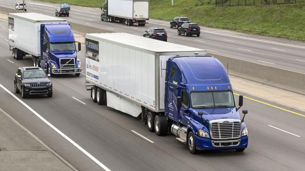

 Research suggests that trucks running in platoons can save between 4% and 10% in fuel depending on their position in the platoon. ( Photo: Peloton )

What is platooning and why are we getting so close to real-world application? Platooning reduces aerodynamic drag by closely grouping tractor-trailers together via electronic coupling. The vehicles travel at a relatively close distance to minimize drag. The first vehicle serves as the leader with each successive truck in the platoon connected and controlled autonomously by the lead truck. A driver in a trailing vehicle could pull his vehicle out of the platoon at any time and all remaining vehicles would automatically close the gap between vehicles.
