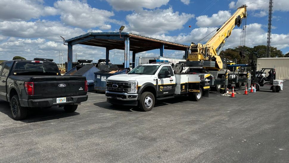

Coltrain’s units are equipped with the Miller Trailblazer 330 Air Pak, a combination welder, generator and compressor. That single piece of equipment changes the conversation. It means welding and trailer body work happen in the yard, which Kyle described as close to unheard of in a mobile environment and something that surprises most of the people he sits down with.
The company’s own materials put the figure at 95 percent of routine repairs and maintenance handled on site. In the episode, the brothers filled in what that covers: engine diagnostics through a direct plug into the truck, after-treatment work including DEF system sensors and diesel particulate filter replacement, brake jobs down to shoes, drums and chambers, air conditioning, lighting, and bolt-on components including starters, alternators and radiators.
The remaining 5 percent is defined by two things, and Kevin was direct about both. Internal engine work means opening the engine, and an open engine in an outdoor environment invites contamination. Pulling a motor introduces a safety exposure for a technician working without a shop’s lifting infrastructure. Catastrophic body and accident damage goes to a body shop for paint. Those jobs leave the yard because quality and safety say so, not because the truck cannot carry the tools.
