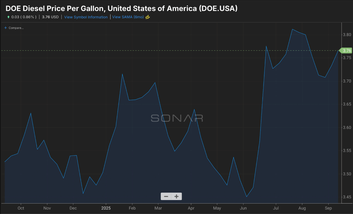

(Photo: SONAR. Diesel Price Per Gallon. Fuel prices for the year are nearing their highest points in over a year and up $.30 from June.)
