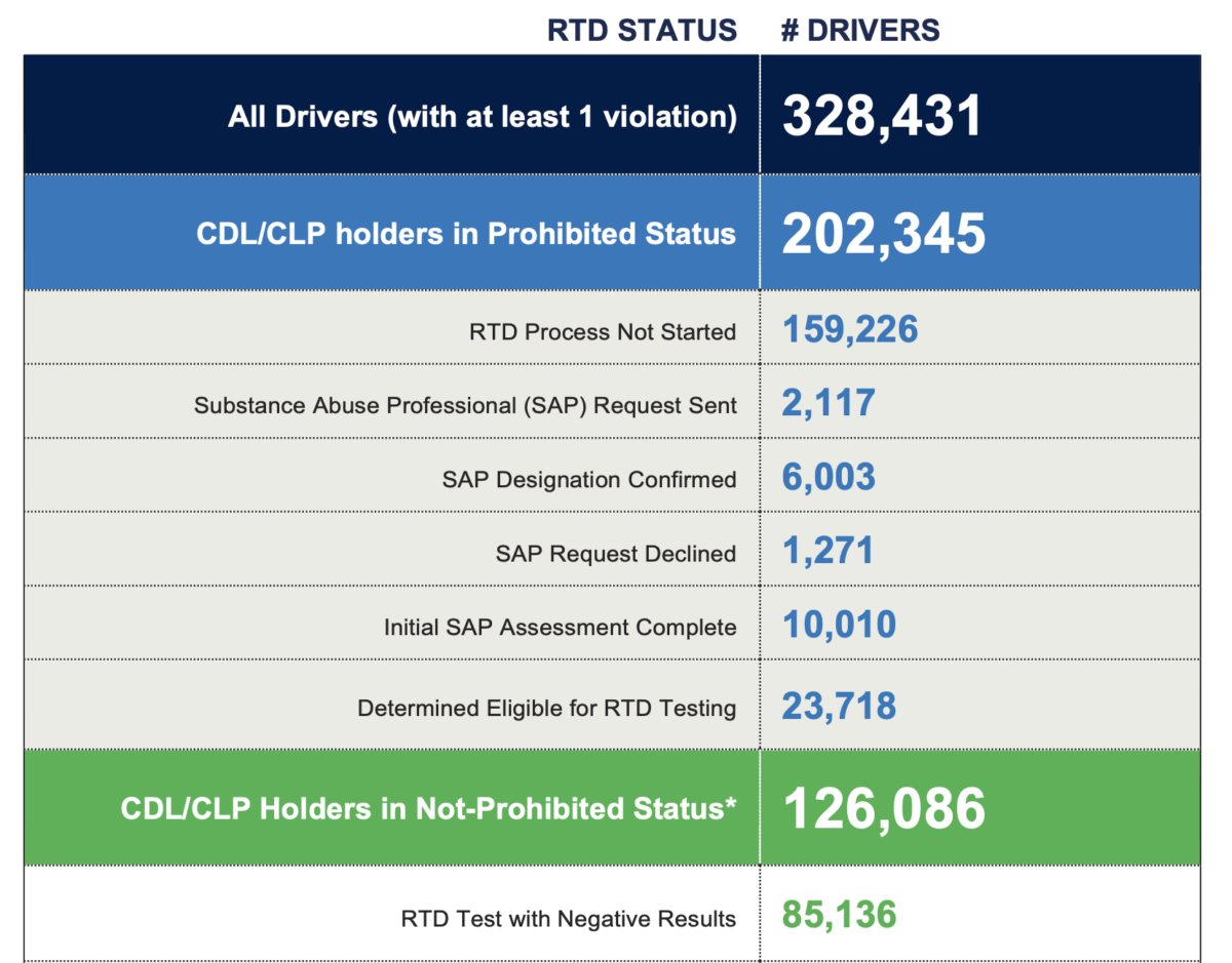

The chart below is real. It comes directly from FMCSA’s Drug and Alcohol Clearinghouse. It is publicly available. And based on the coverage it has received relative to its significance, it might be the most important piece of data in the trucking industry that the industry has largely ignored.
Here is what it says, in plain language, and then here is what it means for every carrier operating in the current environment.
What the Chart Actually Shows
The FMCSA Drug and Alcohol Clearinghouse launched in January 2020. It is a federal database that tracks every drug and alcohol testing violation for CDL and CLP holders in the United States. When a driver tests positive or refuses a test, the violation is reported to the Clearinghouse. From that point forward, the driver is in “prohibited” status — they cannot legally perform safety-sensitive functions, including operating a commercial motor vehicle, for any DOT-regulated employer until they complete the Return-to-Duty (RTD) process.
As of January 2, 2026, the Clearinghouse shows 328,431 total CDL and CLP holders with at least one violation on record. Of those:
202,345 are currently in “prohibited” status — meaning they cannot legally drive a commercial vehicle right now, today. Their CDL has been downgraded to a standard passenger license by their state following the Clearinghouse-II rule that took effect November 18, 2024.
Breaking down where those 202,345 prohibited drivers are in the process:
  • 159,226 have not started the RTD process at all. They received a violation, and they have done nothing. No SAP evaluation request sent, no contact with a Substance Abuse Professional, nothing.
  • 2,117 had an SAP request sent but it has not been confirmed
  • 6,003 have a SAP designation confirmed — they are assigned to a SAP but have not completed the evaluation
  • 1,271 had their SAP request declined
  • 10,010 completed the initial SAP assessment
  • 23,718 have been determined eligible for RTD testing — they finished the SAP process and are waiting to pass a return-to-duty drug test
On the other side: 126,086 are in “not prohibited” status, meaning they went through the RTD process and completed it. Within that group, 85,136 have a negative RTD test result on file, and 40,950 have completed their entire follow-up testing plan.
