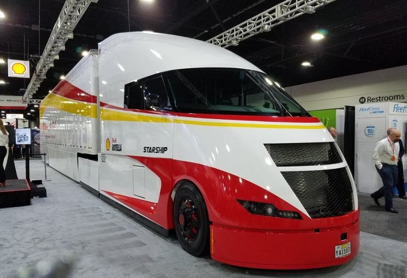

The Starship is a futuristic-looking, but completely road legal, Class 8 tractor-trailer unit built through a collaboration between Shell and AirFlow Truck Company. Designed with super sleek aerodynamic panels made of carbon fiber, the truck features a full suite of advanced technologies as Shell and AirFlow worked to design a truck that would improve freight efficiency as measured by ton-miles.
Bob Sliwa, president of Newington, CT-based AirFlow, said it took 18,000 hours to build the vehicle, which he drove from Newington to Atlanta for the show. “This is not a converted truck,” he said, “this is a 100% bespoke.”
The tractor features a Cummins X15 engine with 6X2 configuration and a 2.5 ratio. The 6-cylinder engine produces 400 horsepower and 1850-foot pounds of torque. The vehicle has both a downsped axle and engine to reduce fuel usage, the latest safety technologies and auto tire inflation system to name just a few characteristics.
Dan Arcy, global OEM technical manager for Shell, said the truck also has both front and side radar, stability control and a solar array on the trailer. The 5,000-watt solar array on top of the trailer provides energy through a 48-volt battery pack to power interior accessories and reduces the energy load.
The body of the Starship Project tractor is a bespoke aerodynamic design made of carbon fiber. This includes the side skirts, hood, and front end. A custom Department of Transportation (DOT)-approved wrap-around windshield was designed specifically for the truck.
Arcy also noted that the truck has an “active front grille” that opens and closes to allow in air as needed.
