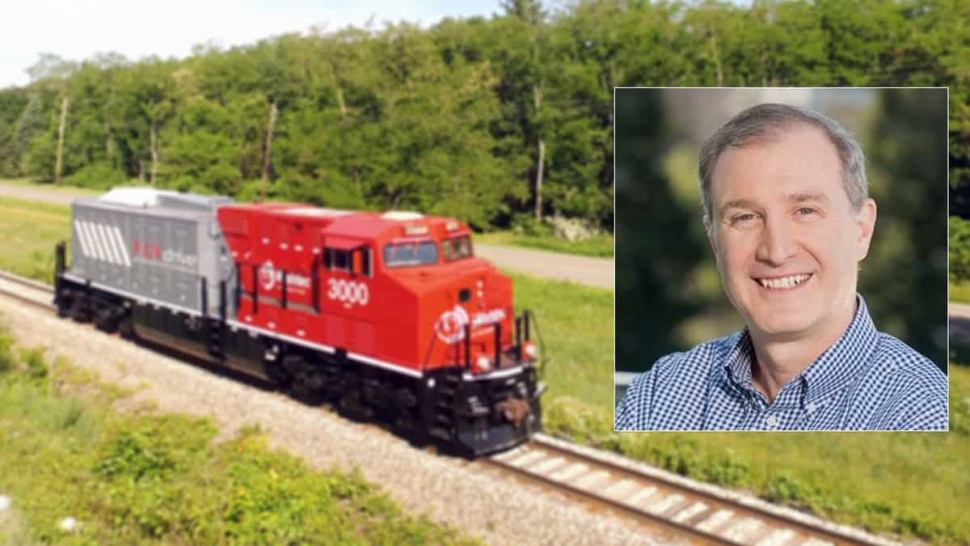

GEBHARDT: “That’s our FLXdrive [battery-electric locomotive] out in California. It goes from Barstow to Stockton, and we’re working in collaboration with BNSF and the California Air Resources Board. FLXdrive has run over 10,000 miles and delivered an average of 10% reduction in fuel consumption across the train. This is the equivalent of 5,000 gallons of diesel fuel saved and approximately 50 tons of CO2 emissions reduced. And so, that’s a significant accomplishment there.
“The battery-electric locomotive is set up in the consist [a group of locomotives] with two diesel electric locomotives. It’s a three-locomotive consist. … It’s almost like a hybrid vehicle but it’s a three-unit vehicle.
“It’s not just running test runs every once in a while. It’s actually running in revenue service [an advanced testing stage]. So, it’s a big step forward. The first of its kind. That [battery system] was at 2.4 megawatt hours. Our next version will be at 6 megawatt hours, and that will be able to save 30% in fuel burn and 30% in efficiency — a big step forward.
“One of the things to remember about the batteries is that the real value is through the regenerative braking. It doesn’t necessarily leave fully charged. It doesn’t get to the end point fully charged. But during the run, anytime the brakes are coming on, we’re charging the batteries. …
“And we have a software overlay called Trip Optimizer. And what this does is that it looks at the entire terrain, the grade of the track, where the hills are coming, and it optimizes the use of the [battery[] power … and with the charged battery, you get to that 10% savings we have. Now, and similarly when we get the battery size up larger, we’ll be able to get up to 30% on the savings, which is a huge step forward.
