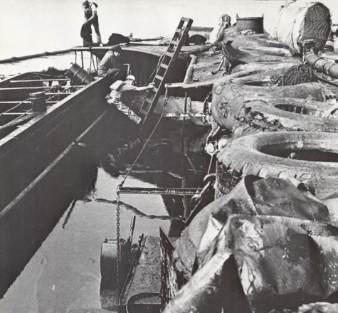

Dredge ‘Caribbean’ capsized in Miami harbor; port re-opened in 11 hours
At about 7:30 p.m. Saturday evening, Jan. 11, the Dredge “Caribbean” of Great Lakes Dredge and Dock Company suffered an internal explosion, rolled over and sank in the main shipping channel to the Port of Miami opposite Dodge Island. The dredge had 3,600 barrels of oil aboard when she went down, threatening a major oil spill in Biscayne Bay.

The initial boom deployed by the Belcher team had been stored on Dodge Island, not far from the scene of the accident, by Belcher and the Port of Miami Spillage Clean-Up Committee. Initial deployment was made difficult by wind and a second barrier was deployed for safety.
As soon as the initial spill was under control, Walter Bird, president of Commercial Divers, was brought in by Great Lakes on a 24-hour basis to plug any leaks that might develop in the dredge. Harold Daniel, president of Danmark Inc., was engaged by Great Lakes to help clean up the spill.
By 6:30 Sunday morning, the boom was secured and Daniel began pumping out oil, which he said was between four and six inches deep. The oil was pumped out at a rate of five to eight hundred gallons per minute into a fuel oil barge, which was alongside the dredge when she went down. Daniel said a vacuum-centrifugal pump was used.
By 9 a.m. Sunday, the channel, which had been closed soon after the dredge went down, was reopened, permitting the departure of the Starward, which had to delay its departure by approximately 11 hours. Also, Sunday morning, the dredge’s silt curtain, designed to prevent the movement of silt from the dredging area, was deployed to assist in the containment of oil.
Great Lakes officials reported approximately 4,200 barrels of oil had leaked and been cleaned up during the first four days of cleanup operations. After the collection of most of the oil that was spilled, the use of the larger pump for removing oil from the water became impractical, and Daniel deployed a small skimmer to collect the thinner levels of oil. After the skimmer had done all it could do, water wipers were used to collect most of the remaining oil.
For the collection of oil sheen that escaped from the boom, an absorbent boom developed by Danmark was deployed at the corners of Dodge Island. Daniel said that after the initial cleanup operation, the main problem was to be sure that any new leaks that developed were contained quickly.
