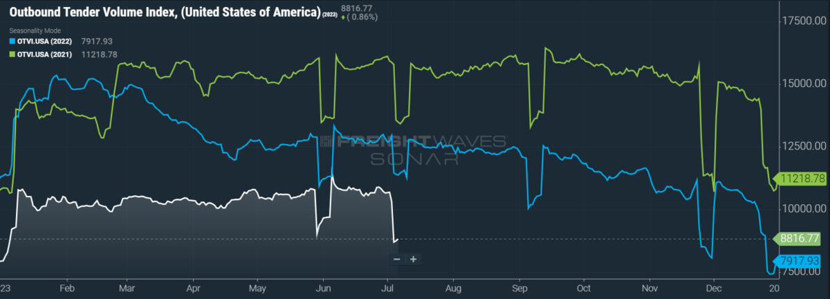

Signals from the Outbound Tender Volume Index (OTVI) will be a bit erratic until next week, as the holiday noise from Tuesday will be skewing volume levels. Since OTVI is calculated as a seven-day moving average, and since freight demand on the Fourth of July was effectively absent, the current dip should not be alarming by itself.
Nevertheless, demand from retail shippers is historically quiet in the period from now until August, after which retailers restock their shelves for the back-to-school season. But given that many retailers have already noted their reluctance to invest heavily in inventory out of fears for flagging consumer demand, even the traditional peaks of August and September will likely be less “peaky” than usual.
Tender volumes are well below year-ago levels:

OTVI fell an unsurprising (but patriotic) 17.76% on a week-over-week (w/w) basis as holiday noise affects this week’s data. On a year-over-year (y/y) basis, OTVI is down 23.07%, although such y/y comparisons can be colored by significant shifts in tender rejections. OTVI, which includes both accepted and rejected tenders, can be artificially inflated by an uptick in the Outbound Tender Reject Index (OTRI).

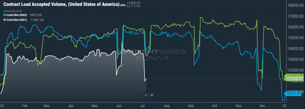

Contract Load Accepted Volume (CLAV) is an index that measures accepted load volumes moving under contracted agreements. In short, it is similar to OTVI but without the rejected tenders. Looking at accepted tender volumes, we see a dip of 17.3% w/w as well as a fall of 19.2% y/y. This y/y difference confirms that actual cracks in freight demand — and not merely OTRI’s y/y decline — are driving OTVI lower.

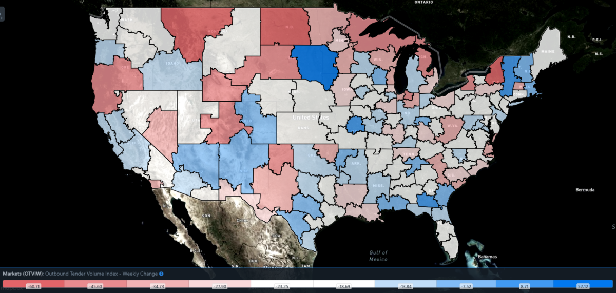

Of the 135 total markets, only four reported weekly increases as freight demand took a breather on the federal holiday.

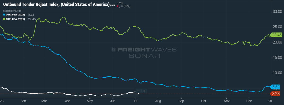

Over the past week, OTRI, which measures relative capacity in the market, fell to 3.28%, a change of 53 basis points (bps) from the week prior. OTRI is now 383 bps below year-ago levels, with y/y comparisons becoming only more favorable as the year progresses.

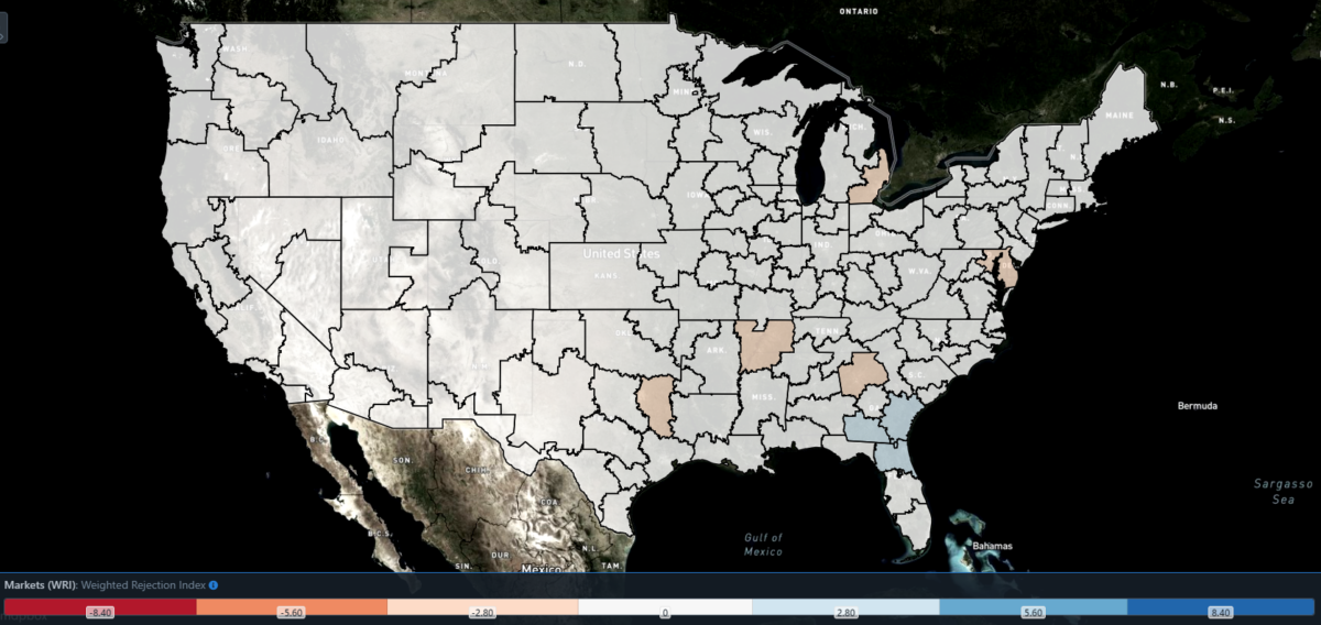

The map above shows the Weighted Rejection Index (WRI), the product of the Outbound Tender Reject Index — Weekly Change and Outbound Tender Market Share, as a way to prioritize rejection rate changes. As capacity is generally finding freight this week, a few regions posted blue markets, which are usually the ones to focus on.
Of the 135 markets, 45 reported higher rejection rates over the past week, though 33 of those saw increases of only 100 or fewer bps.

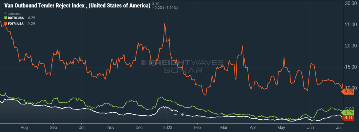

By mode: Despite having the highest reading among the three modes, it is easy to say that the Flatbed Outbound Tender Reject Index (FOTRI) is in the roughest shape at present. FOTRI, which was almost at 16% at the start of June, has since tumbled back into the single digits. U.S. industrial activity has slowed significantly over the past year and domestic construction might soon take a turn for the worse, leaving FOTRI with few remaining sources of upward pressure. FOTRI is now at 9.29%, having fallen 191 bps w/w.
Reefer rejection rates have dropped back to the levels of early June, but they did not have such an unambiguous rally in that month as van rejection rates did. So, while the Reefer Outbound Tender Reject Index (ROTRI) is down 70 bps w/w, it remains somewhat close to its recent highs. The Van Outbound Tender Reject Index (VOTRI), meanwhile, has shed 61 bps w/w to 3.1%.

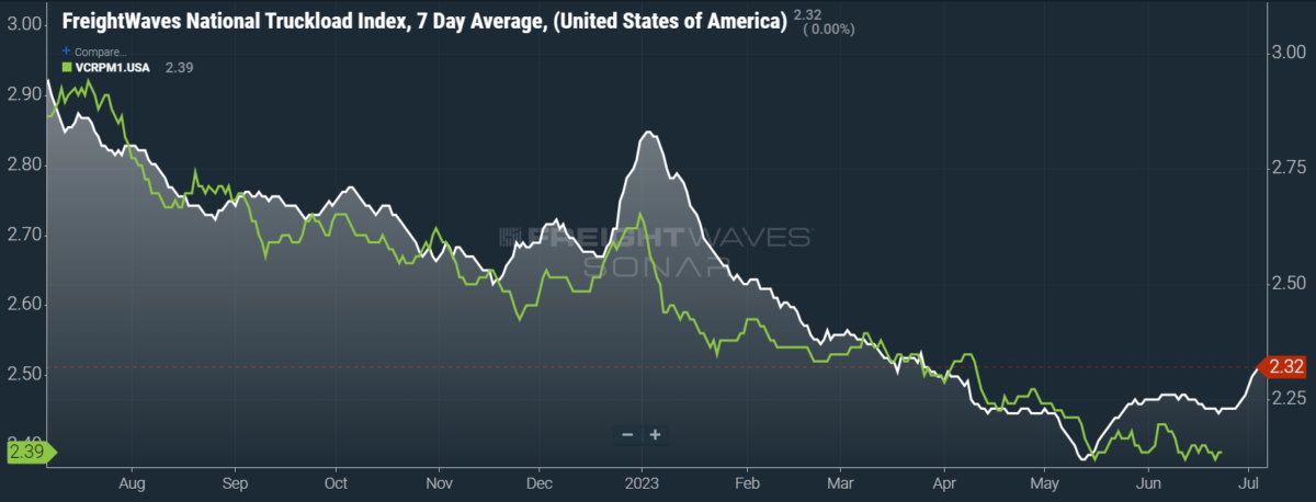

This week, the National Truckload Index (NTI) — which includes fuel surcharges and other accessorials — rose 7 cents per mile to $2.32. Rising linehaul rates were the sole culprit behind this week’s gain, as the linehaul variant of the NTI (NTIL) — which excludes fuel surcharges and other accessorials — also rose 7 cents per mile w/w to $1.72.
Contract rates are reported on a two-week delay, but data from late June suggests that they have little inclination to decline further. It will be interesting to see how the federal holiday has impacted contract rates this year since, in 2022, contract rates fell briefly into a divot around July 4. In any case, contract rates — which exclude fuel surcharges and other accessorials like the NTIL — have remained unchanged w/w at $2.39 per mile.

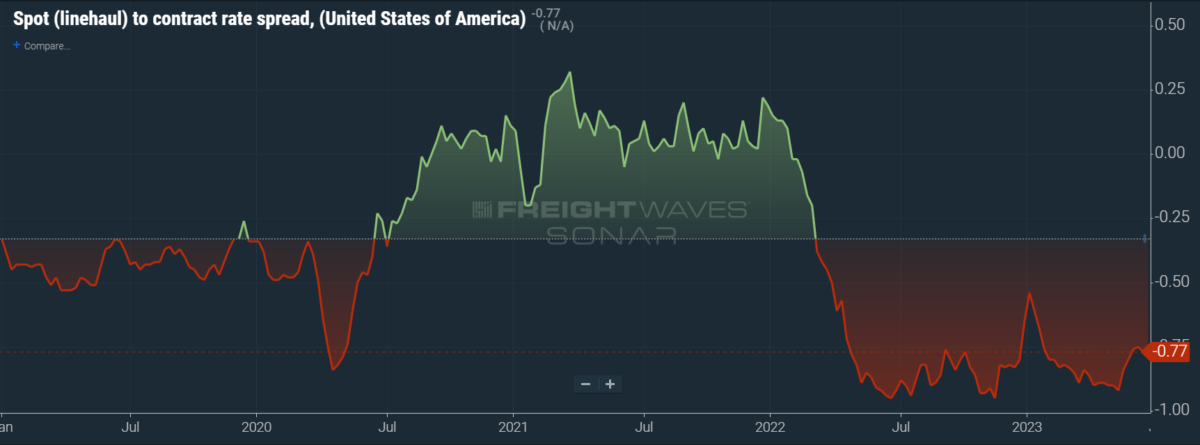

The chart above shows the spread between the NTIL and dry van contract rates, revealing the index has fallen to all-time lows in the data set, which dates to early 2019. Throughout that year, contract rates exceeded spot rates, leading to a record number of bankruptcies in the space. Once COVID-19 spread, spot rates reacted quickly, rising to record highs seemingly weekly, while contract rates slowly crept higher throughout 2021.
Despite this spread narrowing significantly early in the year, tightening by 20 cents per mile in January, it has since widened again. Since linehaul spot rates remain 77 cents below contract rates, there is still plenty of room for contract rates to decline — or for spot rates to rise — in the rest of the year.

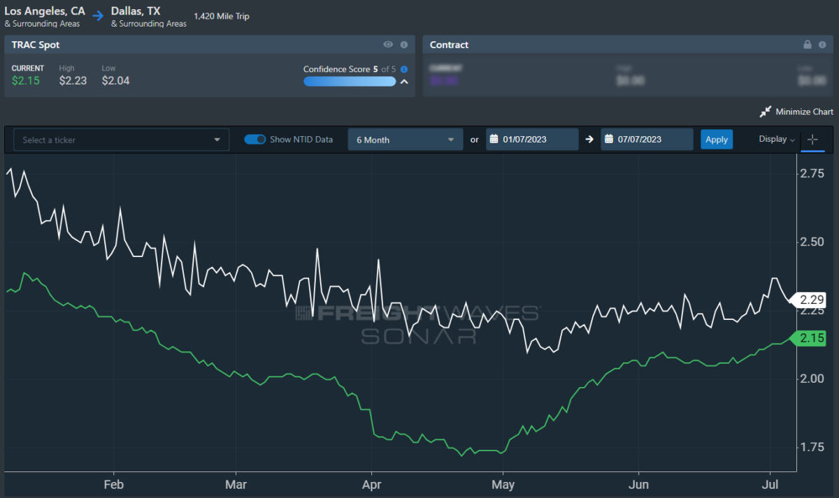

The FreightWaves Trusted Rate Assessment Consortium (TRAC) spot rate from Los Angeles to Dallas, arguably one of the densest freight lanes in the country, continues to distance itself from April’s floor. Over the past week, the TRAC rate rose 4 cents per mile to $2.15 — still a distance from its year-to-date high of $2.39. The NTID, which has ticked down to $2.29, is handily outpacing rates from Los Angeles to Dallas.

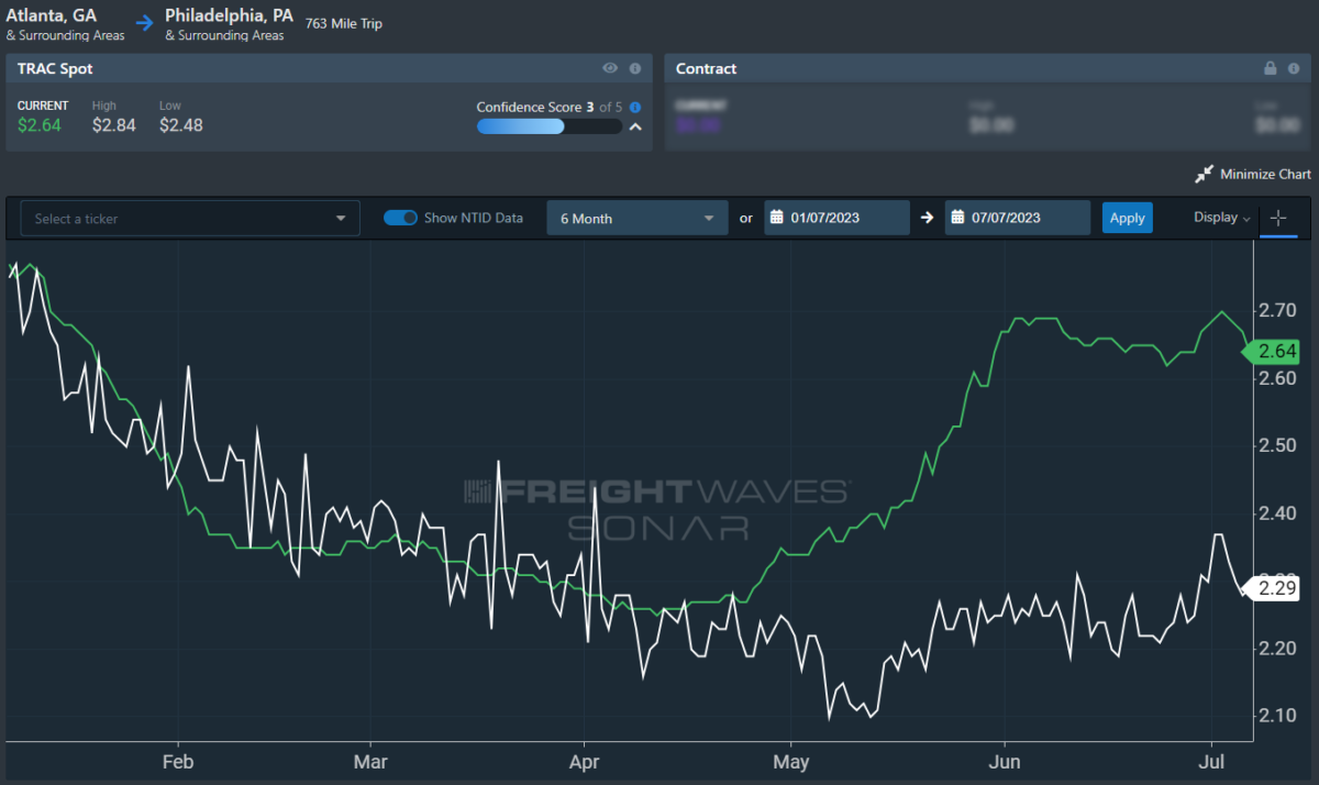

On the East Coast, especially out of Atlanta, rates have come down a bit but are still outpacing the NTID. The FreightWaves TRAC rate from Atlanta to Philadelphia fell 3 cents per mile w/w to $2.64. After a bull run that started at the end of April, this lane has been plateauing above the national average, which is making north-to-south lanes in the East far more attractive than West Coast alternatives.
