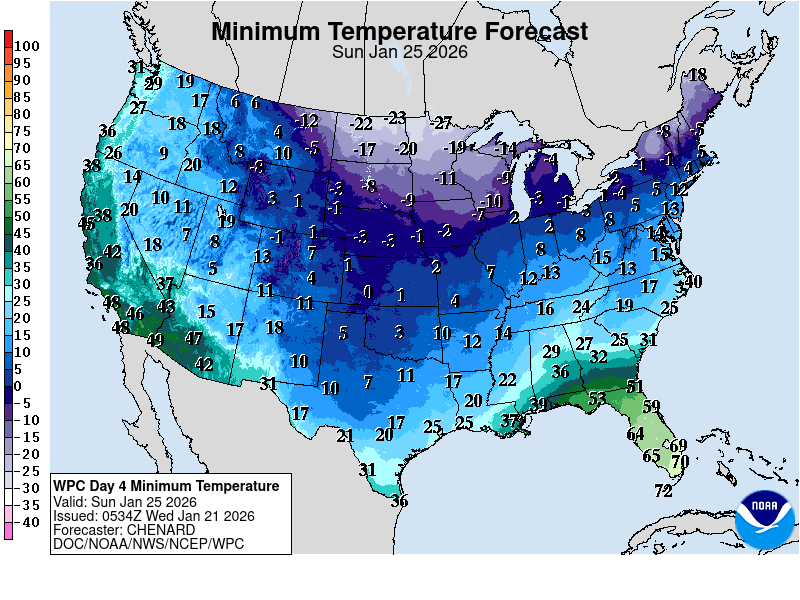

As an Arctic air mass plunges southward, the United States braces for brutally low temperatures this weekend, January 24-25, 2026. Forecast models predict highs in the single digits to below zero across the Upper Midwest, with wind chills dipping to -30°F or lower, while the South and East could see teens to low 20s—unseasonably frigid for regions like Texas and the Carolinas.
(Map: National Oceanic and Atmospheric Administration).

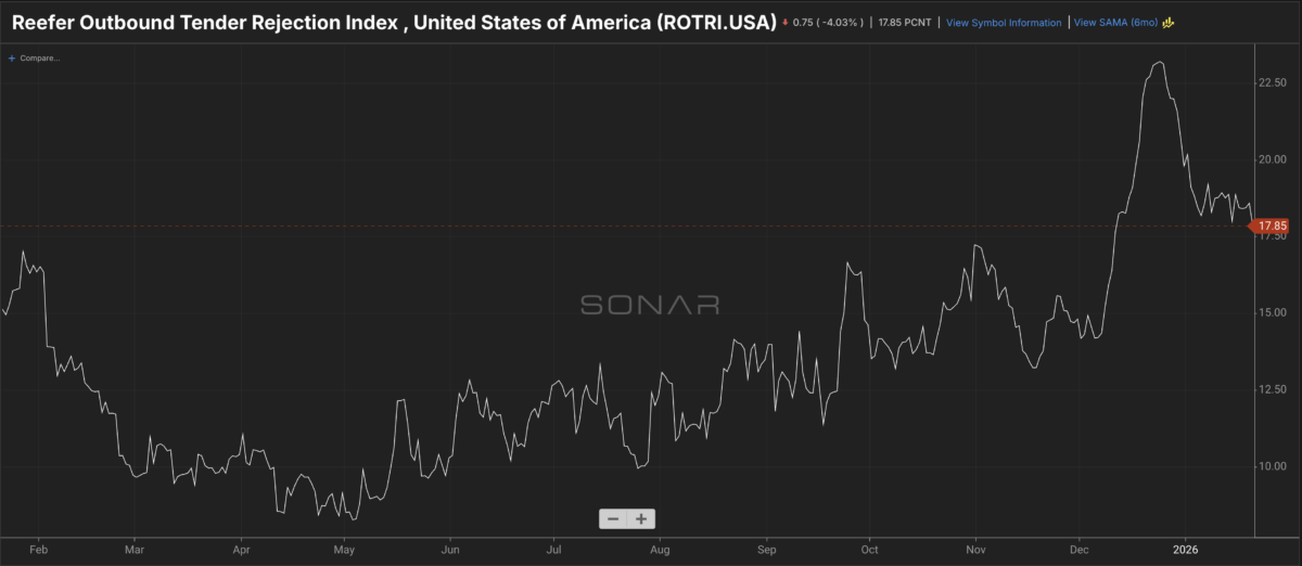

(Tender rejections for refrigerated truckload shipments are already at 17.85%, and protect-from-freeze demands could tighten reefer capacity even further. Chart: SONAR. To learn more about SONAR, click here)
The massive geographic extent of this freeze—from the Plains to the East Coast—will spike demand for insulated and temperature-controlled trailers under “protect from freeze” (PFF) protocols. Goods with freezing points at or below 32°F, like beverages, chemicals, paints, and perishables, require safeguards to prevent damage. Carriers offer PFF services using heated trailers, reefers set above freezing, pallet covers, cargo blankets, and expedited routes through heated terminals.
With over 30 states affected, shippers must label bills of lading “Protect from Freeze,” but limited reefer availability could drive up rates 10-20% amid competition from food and pharma sectors. This surge exacerbates capacity crunches, as standard dry vans offer insufficient insulation, forcing reroutes or holds that ripple through supply chains.
