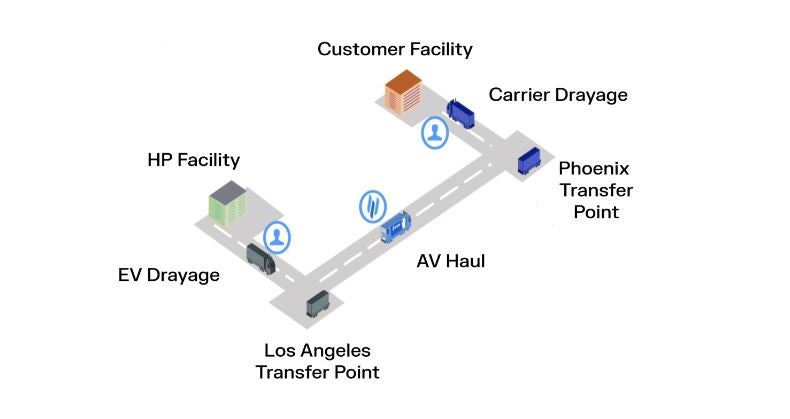

Transfer hub networks would use autonomous truck ports to hand off trailers between human-driven trucks and driverless autonomous trucks. Autonomous trucks would carry freight between the hubs. Conventional trucks with human drivers cover the first and last miles.

Embark Trucks is testing BYD electric trucks for the drayage portion of its autonomous truck freight runs. (Image: Embark Trucks)
