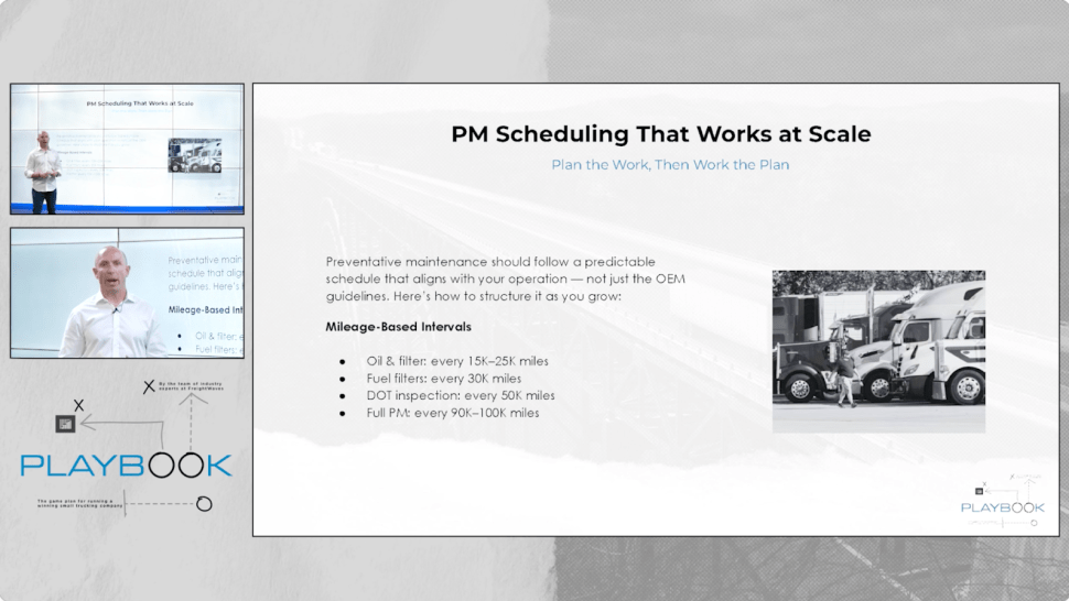

1. Preventive Maintenance Scheduling
This isn’t just about following the OEM’s PM intervals. It’s about adapting those intervals based on your operating conditions.
  • Are you running heavy freight?
  • Are your routes full of stop-start city driving?
  • Are your drivers idling a lot?
  • Are you doing more than 10,000 miles/month?
You need a calendar-based AND mileage-based system. Use oil sample data to fine-tune it. If you’re not sampling your oil yet, you’re flying blind.
