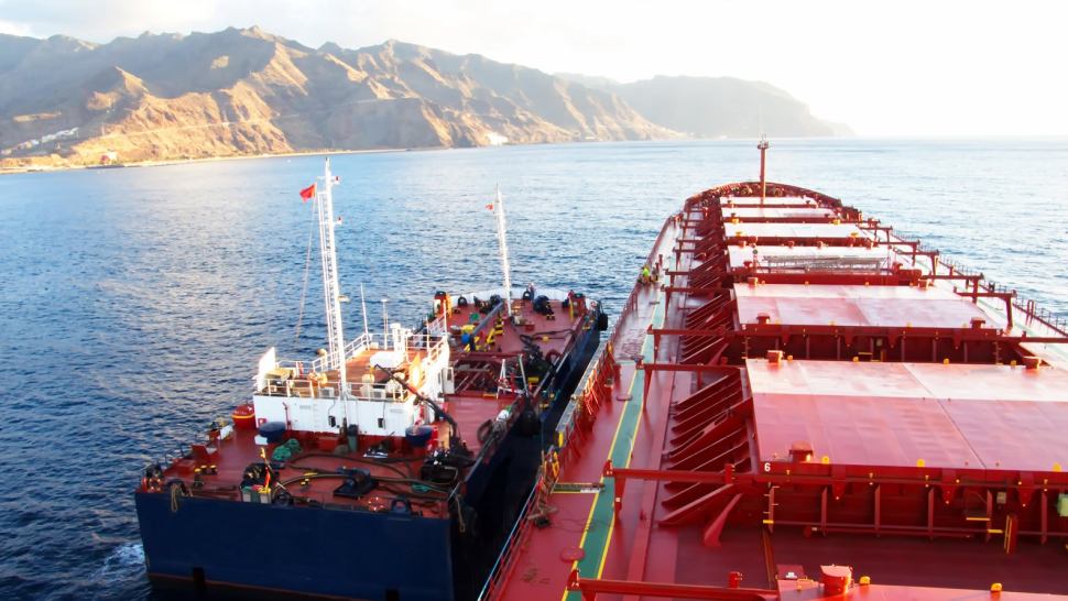

Some businesses fight new environmental regulations tooth and nail. Others figure out how to make money off them. Take the IMO 2020 regulation that slashed sulfur content of shipping emissions. Many shipowners have transformed this landmark global emissions regime into a huge competitive advantage.
Since the regulation’s enforcement date on Jan. 1, 2020, ships have had to use more expensive fuel with 0.5% sulfur content known as very low sulfur fuel oil (VLSFO), or fuels with even lower sulfur content.
The exception: Ships can install exhaust gas scrubbers at a cost of around $2 million-$3 million per ship. Scrubber-equipped vessels can continue to burn the cheaper fuel used pre-2020 that has 3.5% sulfur content, known as high sulfur fuel oil (HSFO).
If the spread between HSFO and VLSFO is wide enough, the fuel-cost savings cover the cost of the scrubber installations and generate profits thereafter.
