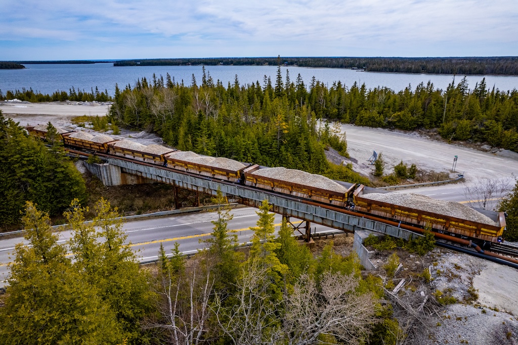

The operation is the world’s first commercial application of autonomous railcar technology, said presenters Katie Kloentrup, senior digital engineer at mining company Carmeuse Americas, and Alex Peiffer, chief operating officer of tech startup Intramotev.
The project using Intramotev’s TugVolt self-powered railcars in six-car trains to move limestone from mine to port at a Carmeuse mine in Cedarville, on Michigan’s Upper Peninsula, was announced in 2024. And while it has immediate benefits for Carmeuse, Peiffer told the shippers at MARS that it could have much larger applications – such as truck-to-rail conversion.

The Cedarville operation involved retrofitting Difco side-dump cars with battery-electric motors and related technology to allow locomotive-free trains of six cars – three powered and three unpowered – to move between mine and port; at the port, a remote operator dumps the cargo.
“We call it supervised autonomy,” Kloentrup said. “[Operators] sit in the cab of the loader or the cab of a pickup truck. They’ll send it down to the dump, and then they’ll select the car, and select on the tablet when to dump into each pocket [receiving the limestone]. So now we have operator comfort. We’re gaining efficiency by not having to walk along it … and it just works smoother overall.”
Peiffer said the cars include a “perception system which is a blend of cameras, LIDAR radar to basically see the world around it and utilize intelligence to make good decisions, as far as stopping for obstacles and other things of that nature.” And while the operation is on a private route not connected to the U.S. rail network, which frees it from Federal Railroad Administration regulation, it does include grade crossings, so the automated cars do meet Association of American Railroads standards regarding lights, horns, and other safety features.
The mine runs 16 hours a day; during the other eight hours, the cars recharge using standard auto-type recharging stations. While the mine shuts down during the winter, avoiding operating issues with the harshest season on the Upper Peninsula, the cars are on pace to move 1 million tons in a year.
