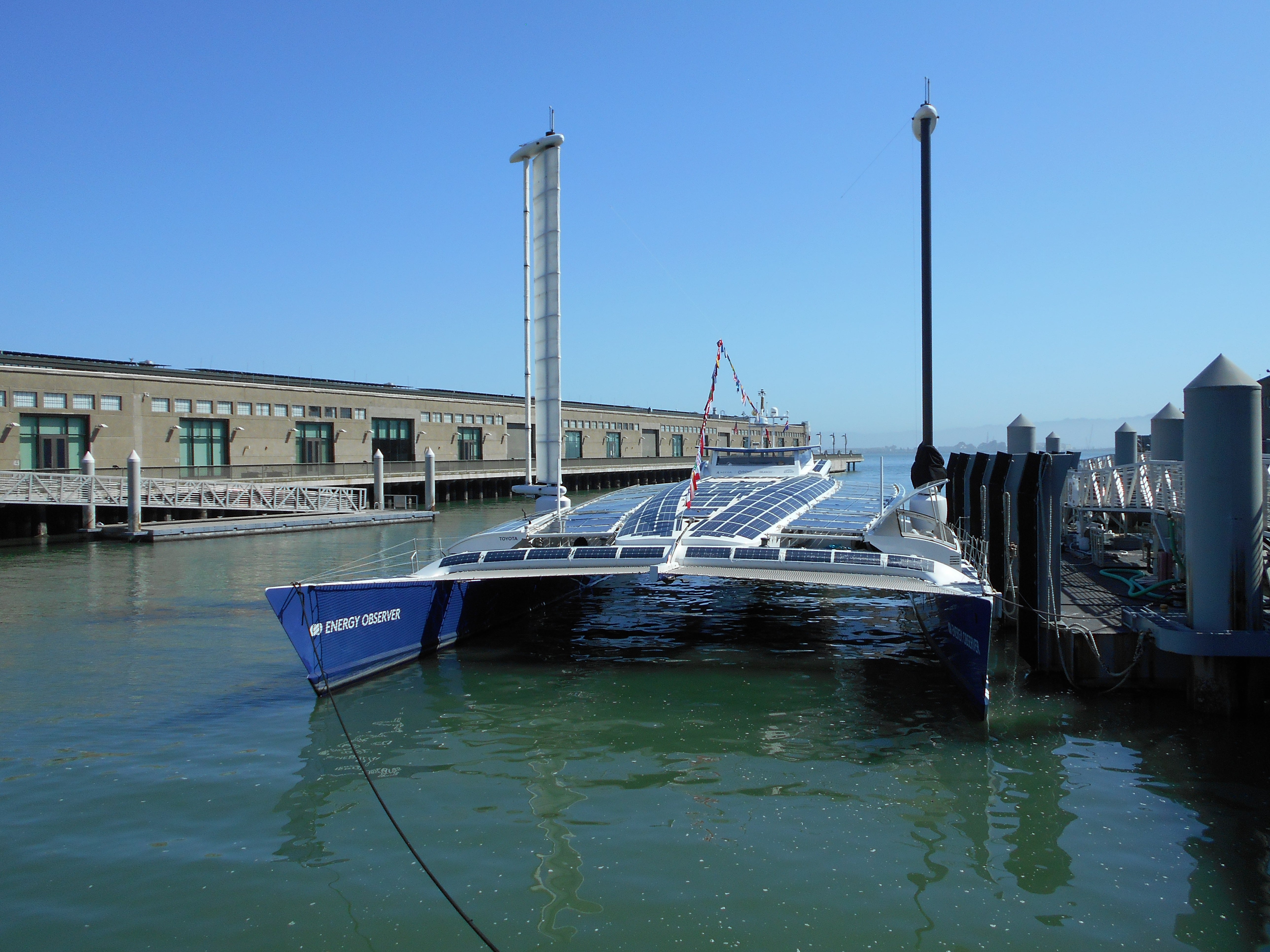

A small, unusual-looking vessel docked in San Francisco last week. It was the Energy Observer’s latest stop on a seven-year, around-the-world cruise to test and publicize the role alternative energy could play in the shipping industry.
The 100-foot-long catamaran, a converted racing boat, carries only five passengers and no cargo. At first blush it might seem irrelevant to the container industry or other segments of the marine cargo industry.

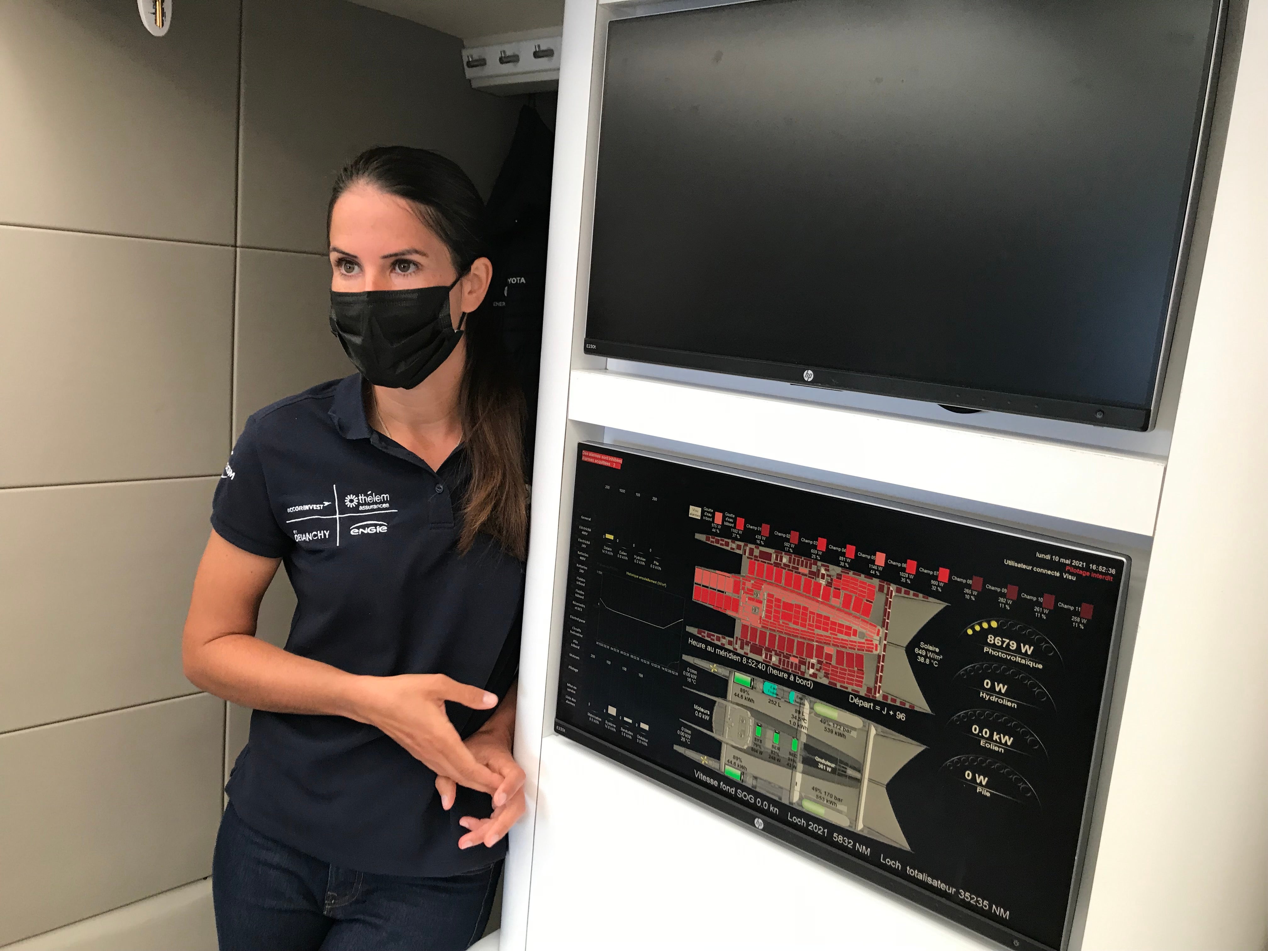

Katia Nicolet, a marine biologist on the Energy Observer, demonstrates the energy management system. (Photo: Chris Dupin)
Katia Nicolet, a scientist on board the Energy Observer, said the ship is attempting to showcase currently available renewable energies that can withstand the harsh environment at sea, including salt spray, extreme temperature, rough seas and lightning.
Nearly the entire upper surface of the ship is covered with 202 square meters of solar cells that generate electricity to charge batteries or manufacture hydrogen through the electrolysis of seawater. The hydrogen is stored in eight tanks below deck.
At night or at other times when sunlight is weak or wind is not available, that hydrogen can be turned into electricity with a fuel cell and used to power the ship’s electric motor and propellers as well as provide power to the Energy Observer navigation system and for the needs of its crew.
The batteries on the ship can generate about 120 kilowatt-hours (kWh) of electricity each day and can store about 100 kWh. The U.S. Energy Information Administration says the average American home uses 29 kWh per day.
The eight tanks on the ship can store hydrogen equivalent to about 2,000 kWh of power — half for propulsion and half to support the crew.

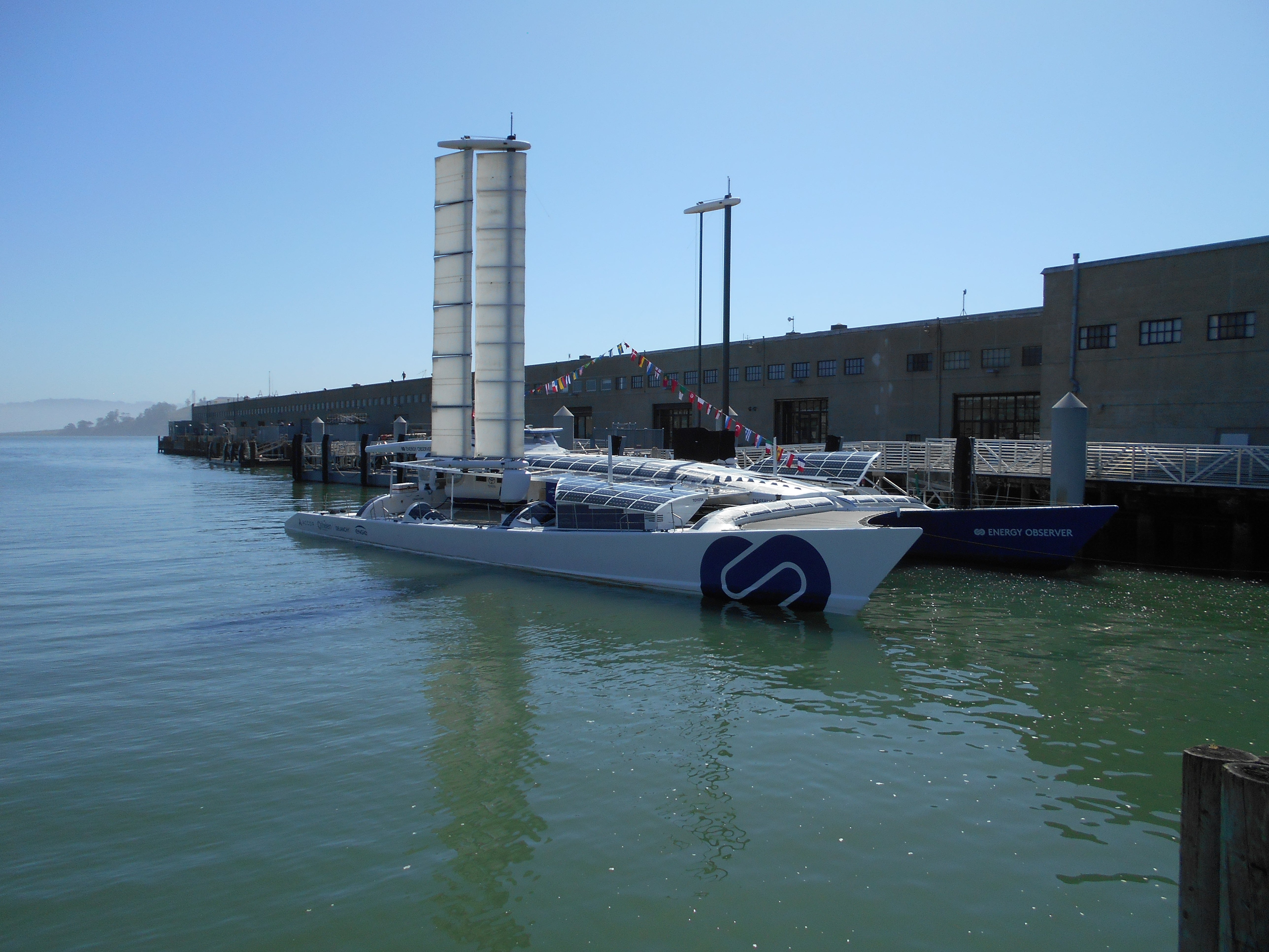

The Energy Observer also sports two OceanWings, inspired by the rigid sails used on the America’s Cup race boats. Nicolet said the OceanWings are twice as efficient as regular sails and do not create much shade on the solar panels.
Unlike the sails on the America’s Cup boats, however, those on the Energy Observer can be reefed to reduce their sail area or furled entirely in unfavorable winds. Energy Observer is also investigating the possible use of flexible solar panels on the wings.
While the ship travels 10-15 knots with good wind, it averages only about 5 knots, whereas big cargo ships sail at up to 20 knots.

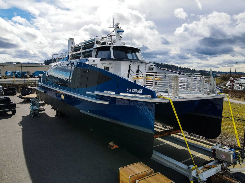

The hydrogen-fueled ferry Sea Change is expected to enter service later this year. (Photo: Zero Emissions Industries)
The owner of the ferry, SWITCH Maritime LLC, says it will operate in San Francisco Bay and will carry 75 passengers.
While the Energy Observer uses a Toyota fuel cell, the same one used in the hydrogen-powered Mirai, the Sea Change uses one supplied by Hydrogenics, now owned by Cummins Inc. (NYSE: CMI).
