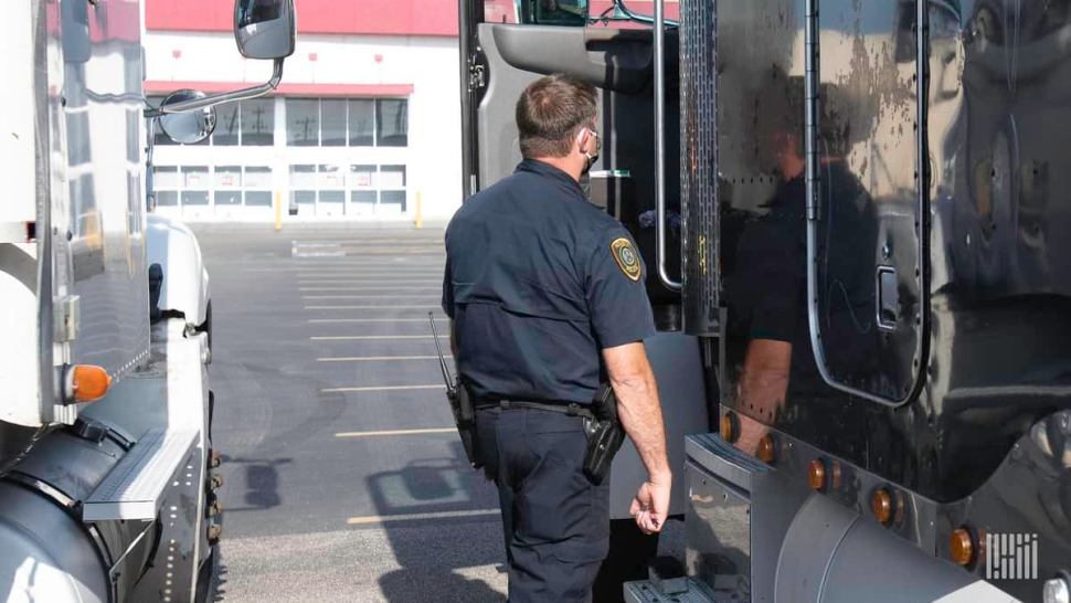

As International Roadcheck 2021 quickly approaches, truck drivers need to prepare for the inspection process. (Photo: Jim Allen/FreightWaves)

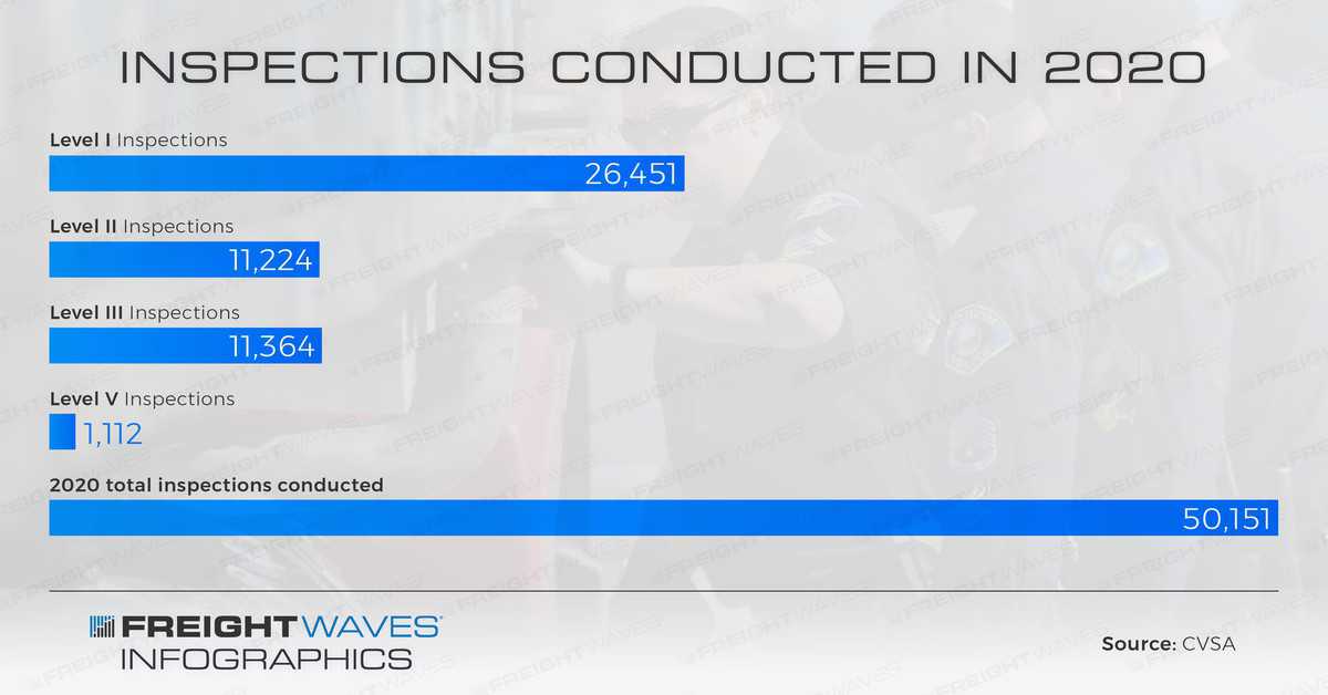

Roadcheck inspectors conducted 25% fewer inspections compared to 2019, although there was a 3% increase to 20.9% of vehicles placed out of service (OOS) and more than 3,200 drivers were placed out of service. Not surprisingly, hours-of-service violations were the reason for 35% of those drivers being placed OOS.

(Graphic: Emily Ricks)
