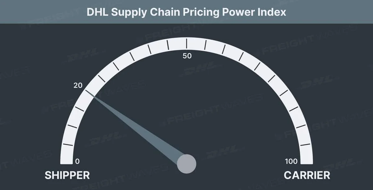

Outbound tender volumes are benefiting greatly from the reopening of the economy and a release of pent-up consumer demand, and the result is the highest level of pricing power for carriers in nearly two months, according to the weekly DHL Supply Chain Pricing Power Index.
Supply dynamics are taking longer to adjust and capacity remains extremely loose. While rates are coming off a depressed base, spot rates have increased in the vast majority of lanes and consumer spending data and a bump from produce season put carriers in a better position than they have been in throughout the past month.
The Index is at a reading of 20 this week, still in extremely positive territory for shippers, but showing improvement for carriers. Any reading below 50 indicates a pricing advantage for shippers while readings above 50 suggest an advantage for carriers.
DHL Index
The DHL Supply Chain Pricing Power Index uses the analytics and data contained in FreightWaves’ SONAR to analyze the market and estimate the negotiating power for rates between shippers and carriers.
