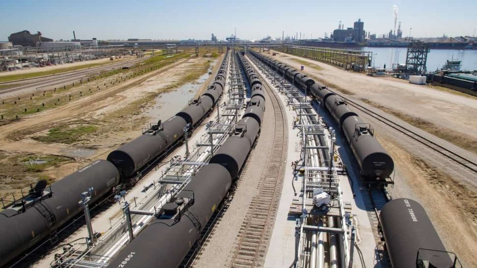

With fears that the world is so overflowing with crude oil that markets will literally run out of places to put it, attention has turned to another option to hold it: railcars.
But it doesn’t look like it’s going to happen, so those who need to be sure those railcars are available for other uses can breathe a sigh of relief.
The reality is that while the economics of storing crude now are so incredibly good — kind of along the lines of “any idiot can make money doing this” — it only works if you’re putting oil into a storage tank or a tanker. It doesn’t work for railcars, according to people familiar with the economics.

According to both Barsamian and John Schmitter, who heads the rail consulting firm KEP LLC, the cost to store oil in a railcar is about $1.50 per barrel per month, far above the 50-75 cents for a storage tank. (Schmitter estimated the cost of leasing a 700-barrel rail tanker is $1,000 per month, which is about $1.43 per barrel per month. So it’s in the $1.50-per-month ballpark.)
That’s $18 for 12-month storage, more than the $15 12-month spread for WTI between May 2020 and May 2021.
As Barsamian notes, it isn’t that simple. There are other crude grades trading at extremely low levels that can be purchased and stored in railcars. For example, Western Canada Select, the benchmark Canadian grade, is trading about $5 a barrel less than WTI. Storing that on railcars and selling it forward would be more complex but the economics would be closer to a workable trade.
But Schmitter said that isn’t all. While the $1,000 per month would be for a “full service lease that includes maintenance on the operating components,” Schmitter added that the lessee is responsible for work needed on valves, other appliances on the car and the tank itself.
“There are also regulatory inspections and certifications required for tank cars,” Schmitter wrote in an email to FreightWaves. “It’s tough to put a dollar cost on these and they do increase as the car gets older. But maybe $50 to $100 per month on average.”
