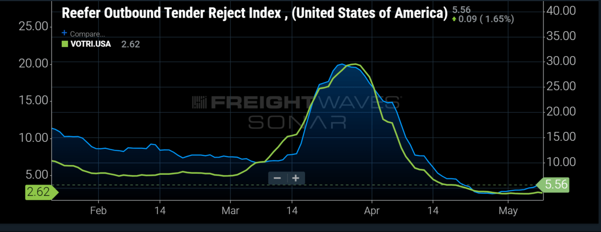

Chart of the Week: Reefer Outbound Tender Rejection Rate, Van Outbound Tender Rejection Rate – USA SONAR: ROTRI.USA, VOTRI.USA
The freight market is still reeling from the economic mess created by the COVID-19 pandemic, but reefer tender rejection rates have been on the rise since bottoming in late April around 3.8%—now sitting around 5.56%. Dry van rejection rates have yet to make a meaningful movement since bottoming around 2.6% in mid to late April. Could the increase in reefer tender rejection rates indicate the market is about to shift?
Tender rejection rates are an indication of carrier willingness or availability to service contracted agreements. When rejection rates increase, spot rates follow and depending on the length of time they remain elevated, contracted rates established in long term agreements will rise as well. “Reefer” is the colloquial term for refrigerated trailer, which specializes in hauling goods that require temperature control such as food and beverages that cannot exceed a certain temperature.
Reefer rejection rates averaged over 16% last year compared to van’s 5.5% rejection rate. Reefer volumes are much smaller in sample size than the van counterparts as most freight can be moved without temperature control, but this smaller size makes the sector much more volatile—hence the fact reefer rejection rates are starting to increase while capacity remains extremely loose for van loads.

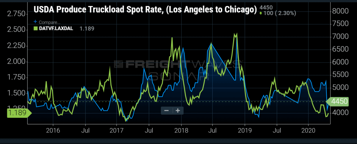

The average spot rate for produce truckloads and dry van truckloads are reasonably connected. Chart: SONAR – AGRATE.LAXCHI, DATVF.LAXDAL
The connection between the reefer and dry van market is not as well understood in the transportation space as the commodities that move on reefer trailers tend to be insulated niche movements. Looking at the average spot rate for produce from L.A. to Chicago and the spot rate for and freight moving from L.A. to Dallas, there is a clear connection in the timing and direction of the rate movement. This connection is driven by the overriding capacity conditions of the freight market. The connection is not one-to-one by any means, as small divergences like the one we are currently seeing today on the national rejection rates.
Only rarely do changes in reefer capacity lead shifts in the van market. Most of the time, the converse occurs seeing as van is the largest percentage of available equipment. The large numbers make them a better sample to judge overall market trends, but less valuable when measuring small isolated events.
In other words, reefer capacity is like the moon orbiting the Earth. They both exert influence on each other, but the Earth (van) carries more weight when measuring the for-hire trucking market.
