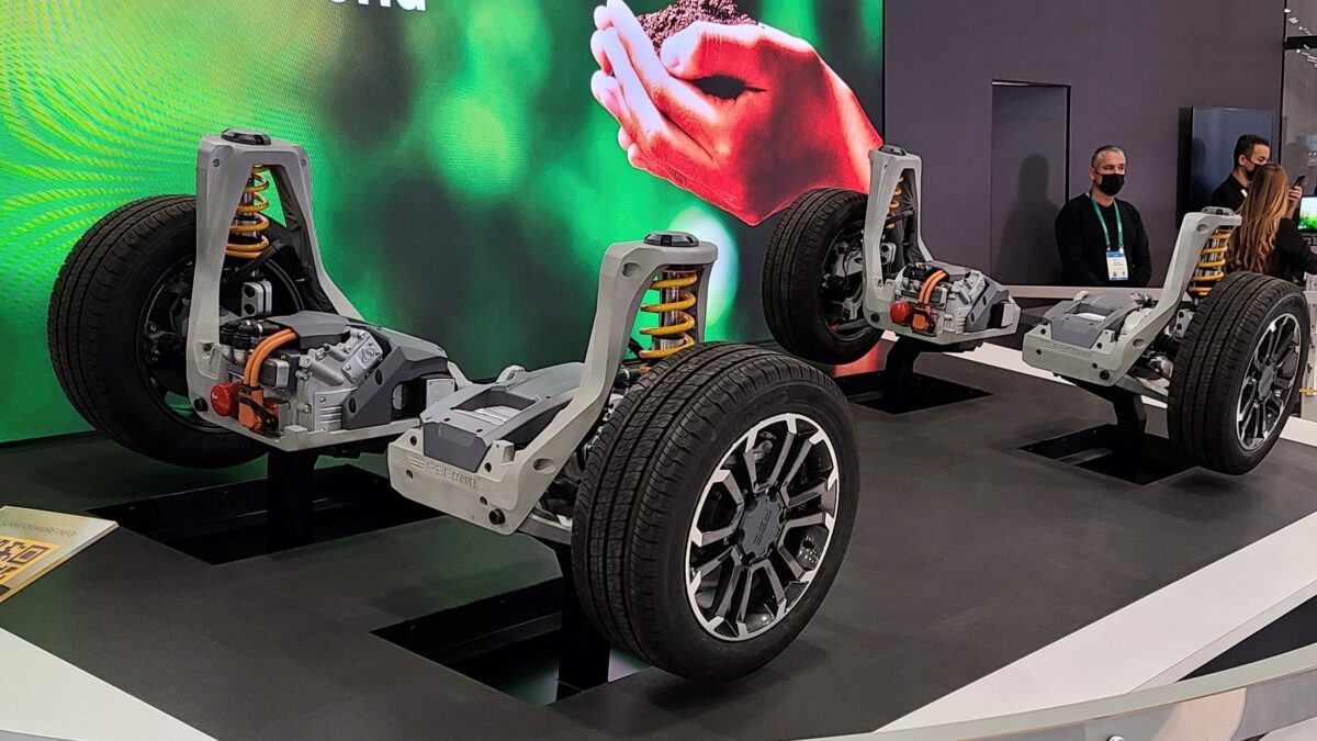

The Reecorner technology on display at CES in Las Vegas in January 2022. (Photo: Alan Adler/FreightWaves)
Understanding what Ree has done requires some explanation. By packing electronically driven motors, braking and steering into a single module controlled by a central computing system, Ree is at the bleeding edge of making mechanical components obsolete.
“You have electrical, electronic and software redundancy, which is the equivalent of mechanical redundancy,” said Peter Dow, Ree vice president of engineering.
So, instead of electric power steering backed by a traditional steering shaft and mechanical pump, Ree provides redundancy through power electronics. A driver will “feel” like he is steering, but computer programming is merely replicating what the driver thinks he is experiencing.

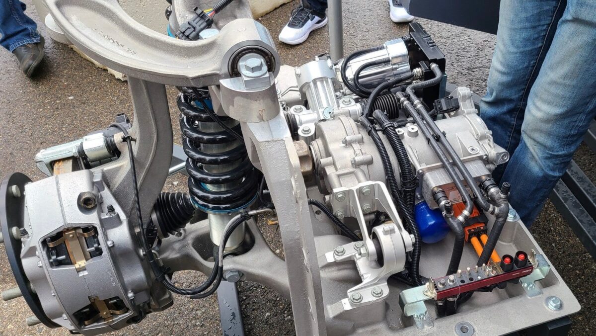

First to full by-wire system
“We are the first one ever to be able to certify a full by-wire system,” CEO Daniel Barel told me. “This is really complicated, but not because of the requirements. The requirements and the regulations do not differentiate between by-wire and non-by-wire.”
When it comes to Federal Motor Vehicle Safety Standards testing, regulators will be looking at how a complete vehicle with the Reecorner works, not at the Reecorner itself.
“We are the first to do it without a full mechanical backup,” Barel said. “When the regulators come to us, they say, ‘We don’t care how you do it. When you show us that if your front brake doesn’t work, show us that you can brake.’”
That’s what Horiba Mira showed: Electronic redundancy was just as effective as a mechanical backup.
The Reecorner on display in June 2022 at a Ree Automotive media event in Ypsilanti, Michigan. (Photo: Alan Adler/FreightWaves)

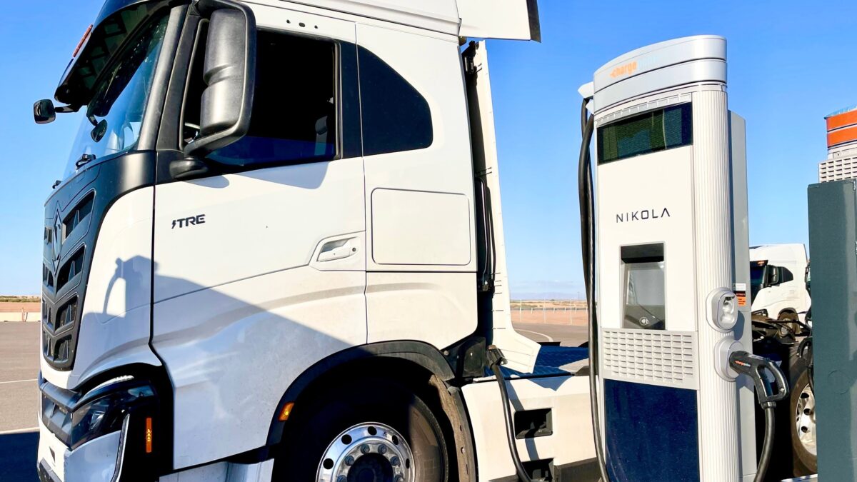

Trevor Van Egmond is quite a negotiator. He managed to get a Nikola Tre battery-electric vehicle essentially for free.
Before he started as president of his own business, Clean Freight Consultants Inc. in Canada, Van Egmond worked for the Alberta Motor Transportation Association (AMTA). He arranged a cost share in which Prairies Economic Development Canada paid $2.8 million Canadian ($2 million) for a Nikola battery-electric and a hydrogen-powered fuel cell electric vehicle.
Nikola ponied up 50% of the cost through in-kind contributions of a Hyla mobile fueling trailer for the fuel cell truck that is pending delivery, plus hydrogen fuel and a ChargePoint charging station for the battery-electric truck. The Hyla trailer will be leased by AMTA in four rural Alberta locations. Bison Transport is currently using the battery-electric truck.

Nikola contributed a charging station, hydrogen fuel and a mobile fueler in a deal with a Canadian government agency. (Photo: Nikola)
