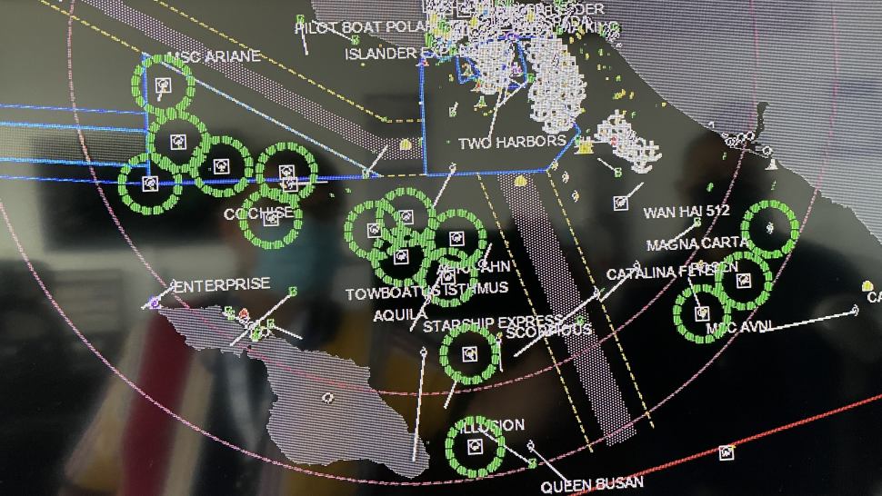

Vessel traffic system screen showing locations of drifting ships on Sept. 10; the number of drifting ships is up significantly since then. (Photo: Marine Exchange of Southern California)
The number of container ships at anchor or drifting in San Pedro Bay off the ports of Los Angeles and Long Beach has blown through all previous records.
The latest peak: There were an all-time-high 73 container ships in the queue in San Pedro Bay on Sunday, according to the Marine Exchange of Southern California (the tally inched back to 69 on Tuesday). Of the ships offshore Sunday, 36 were forced to drift because anchorages were full.
Theoretically, the numbers — already surreally high — could go even higher than this. While designated anchorages are limited, the space for ships to safely drift offshore is not.
“There’s lots of ocean for drifting — there’s no limit,” Capt. Kip Loutit, executive director of the Marine Exchange of Southern California, told American Shipper.
“Our usual VTS [Vessel Traffic Service] area is a 25-mile radius from Point Fermin by the entrance to Los Angeles, which gives a 50-mile diameter to drift ships. We could easily expand to a 40-mile radius, because we track them within that radius for air-quality reasons. That would give us an 80-mile diameter to drift ships,” said Loutit.
